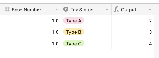

For example, I have three types of tax status.
So when I select type A, it should counted as a formula,
when I select type B, it should be counted as b formula,
I select type C, it should be count as c formula.
Hope this could help, thank you so much.

Oh sure, here
Output field formula:
SWITCH(
  {Tax Status},
  "Type A", {Base Number} + 1,
  "Type B", {Base Number} + 2,
  "Type C", {Base Number} + 3

Thank you so much!!
It works.
