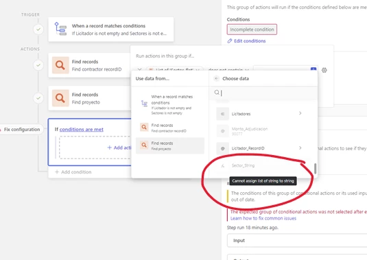

Hi community.
I have a single-select field called Sector in a table called Projects. I'm trying to cast this field to a string.
The reason I'm trying to do this is that I'm trying to build an automation, in which I will need a conditional step that will check this stringified single-select field to a multi-select field in another table to see if the multi-select field contains the the selected value in the single-select field.
Thus far, I've created a formula field in Projects with various formulas (or formulae, for the sticklers out there), including:
- ARRAYJOIN(Sector)
-Sector
-LEFT(Sector)
No matter what, when I go to the automation it won't let me choose the field because AT says "Cannot assign list of string to a string".
Please help!!!
Thank you!

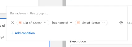

Best answer by Eli_Kent
I was able to make it work by, in the conditional logic step of the automation, choosing the multi-select contractor[Sector] field and then "flatten", and checking if it contains the single-select project[Sector] field. It also worked when I compared contractor[Sector] to the formula field project[Sector_String}. It turned out not to matter if the formula was =Sector or =Concat(Sector).
Here's what the conditional step looks like.
In the end, this prodded me to learn enough scripting to write a script that does this job for me, which really was the best case scenario, anyway.
I appreciate your help, @Alexey_Gusev.

Hey @Alexey_Gusev . thanks for chiming in. unfortunately, when i did that, i got the same results. couldn't select it because "Cannot assign list of string to a string". frustrating. seems like it shouldn't be this difficult.
I'm trying to learn enough scripting now to be able to script it. i'm vaguely familiar with python, so the learning curve isn't too terrible. the record.getCellValueAsString function should come in handy

Forum|alt.badge.img+13
  • October 25, 2023

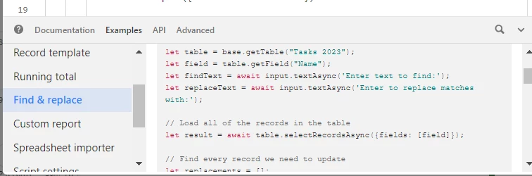

I can say that Airtable is a perfect sandbox to learn JS. I learned its basics here having Pascal/VBA background many years ago.
you can start here , also check available examples and refer to API:
In general, you need to understand arrays, objects and very basics of async/await
Since JS received important new functions with ES6, you can learn some things to make coding much easier:
array-helpers, arrow-functions. (optional: destructuring assignment)
