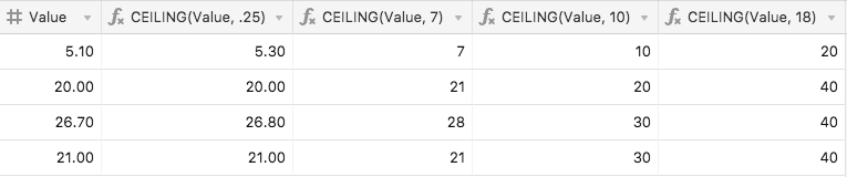

I’m seeing similar odd results. Some ceiling values work fine, while others don’t:

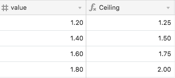

@Jesse_Poteet I received a reply from support. They’ve logged it to fix, and passed along this workaround that appears to do the trick for now:
CEILING(value/significance)*significance
Here’s an example that I ran to confirm, using this formula:
CEILING(value/0.25)*0.25
