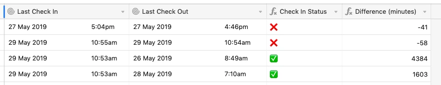

The image below shows the problem. The second row should show a “ :white_check_mark: ” as the Last Check In is 1 minute after the Last Check Out, however the difference between the two times (using DATETIME_DIFF) is showing as 58 minutes.

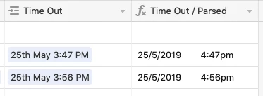

I think the problem is caused by DATETIME_PARSE on another table not correctly setting the timezone (see below). If I have “GMT for all collaborators toggled on” it shows the correct time (as above) but is still being treated as the correct time + 1 hour
