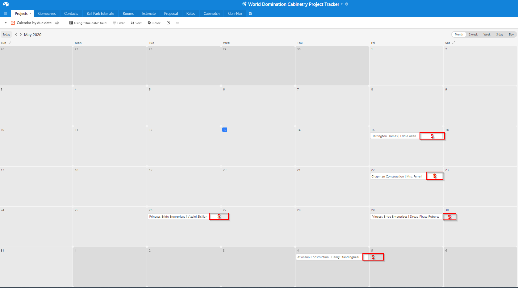

My objective is to see this (the red dollar sign represents my Job Cost field):
So on a calendar view, I want to see a concatenation of the Company Name, Contact Name and the Job Cost. The Company and Contact are two separate linked tables, and work fine in the primary field using the following code: {Link to Companies}&" | "&{Link to Contacts}

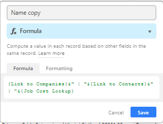

My modified code of:

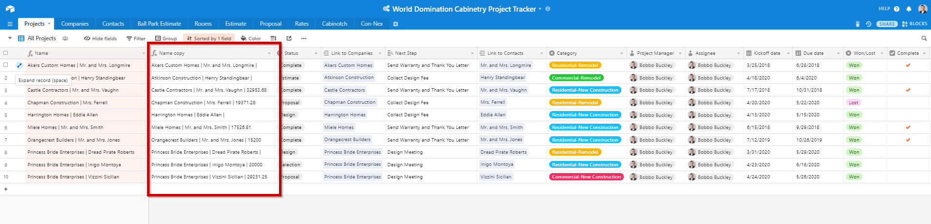

works fine in any field/column other than the primary field/column:

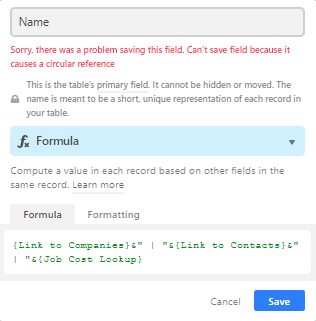

When I add the same code to the Primary Field, I get this error:
Which makes no sense to me (novice apparently). Is there a way to do what I am attempting to do?

Hi @Bobbo_Buckley,
Circular references can cause headaches for novices and experts alike! They’re also a bit difficult to explain at times, but here’s what I noticed from your base.
  • Projects are linked to Proposals, and the primary field in Proposals inherits its name from the primary field in Projects.
  • When trying to reference Job Cost Lookup in the primary field, it can’t function; the value of the primary field in Projects can’t be known without knowing the value of the primary field in Proposals, which in turn relies on knowing the value of the primary field in Projects.
After looking over your base, I’d recommend consolidating your projects and proposals tables into a single table. This will not only get you around the circular reference error, but will decrease the amount of duplicate data you have in your base.
To differentiate proposals from projects, you can take advantage of a single select field to give each record a status (project or proposal), and then use filtered views to separate out the two from one another within the same table.
Let me know if you have any follow-up questions about this!
