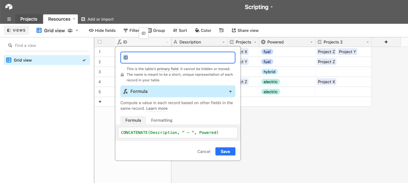

TBH this use case sounds simple enough that someone might have already written what you needed if you at least shared a screenshot, aaa-bbb abstractions are just another obstacle to the mind after a long day. :grinning_face_with_sweat:
See, an image is worth a thousand words, and I have a couple of them for you:
My crude recreation of your base description amid some other random base, the key fields are the linked resources and the rolloup listing their props:
There are many ways to fine-tune its output, but here’s a super-simple one:
You can then filter the results by thos which include a comma, which automatically means it contains more than one of your selected match:
And/or you could use that logic as a basis for a standalone view filter:
Hopefully this proves illuminating but let me know if I misunderstood or you’re still having issues.

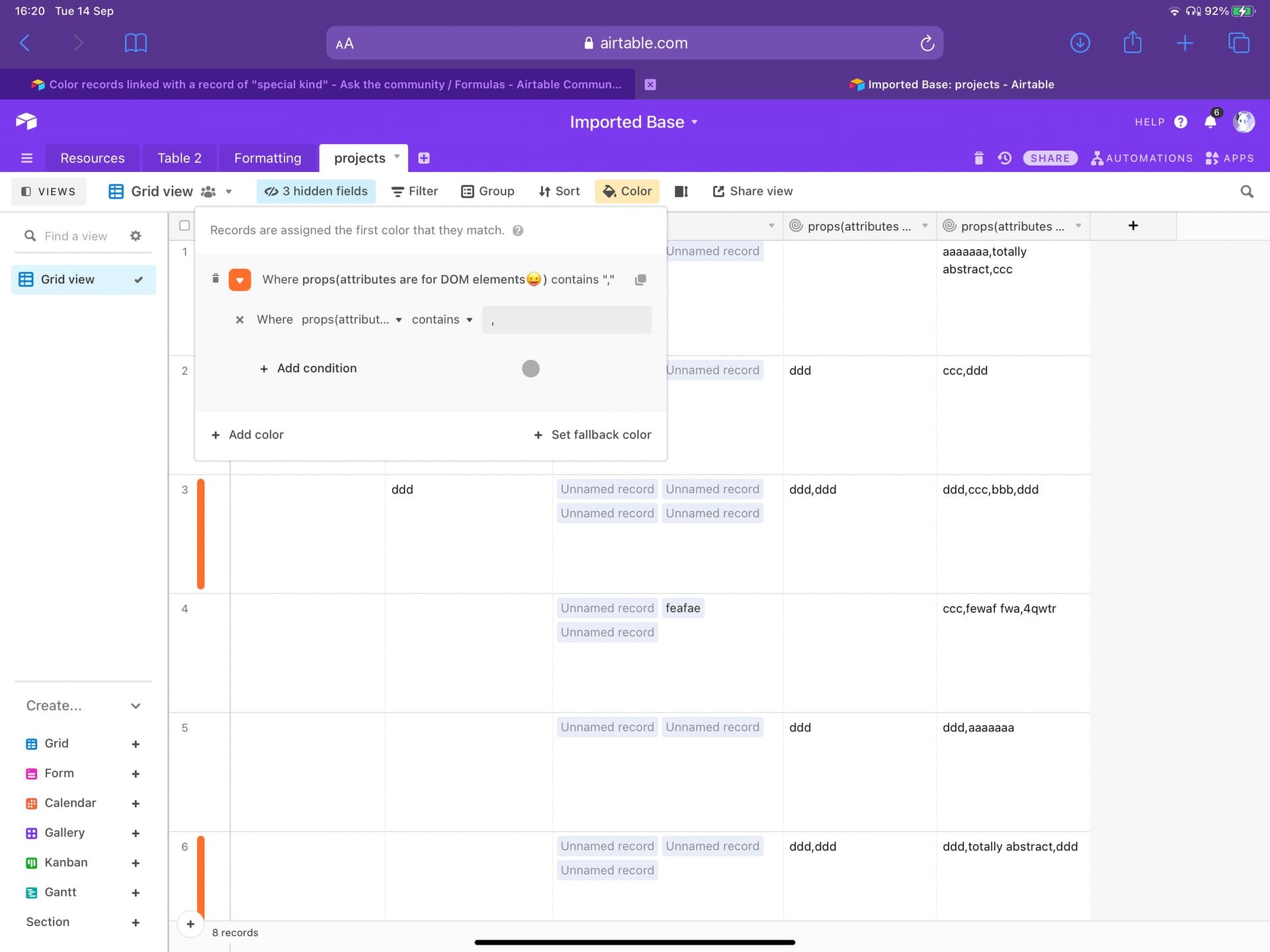

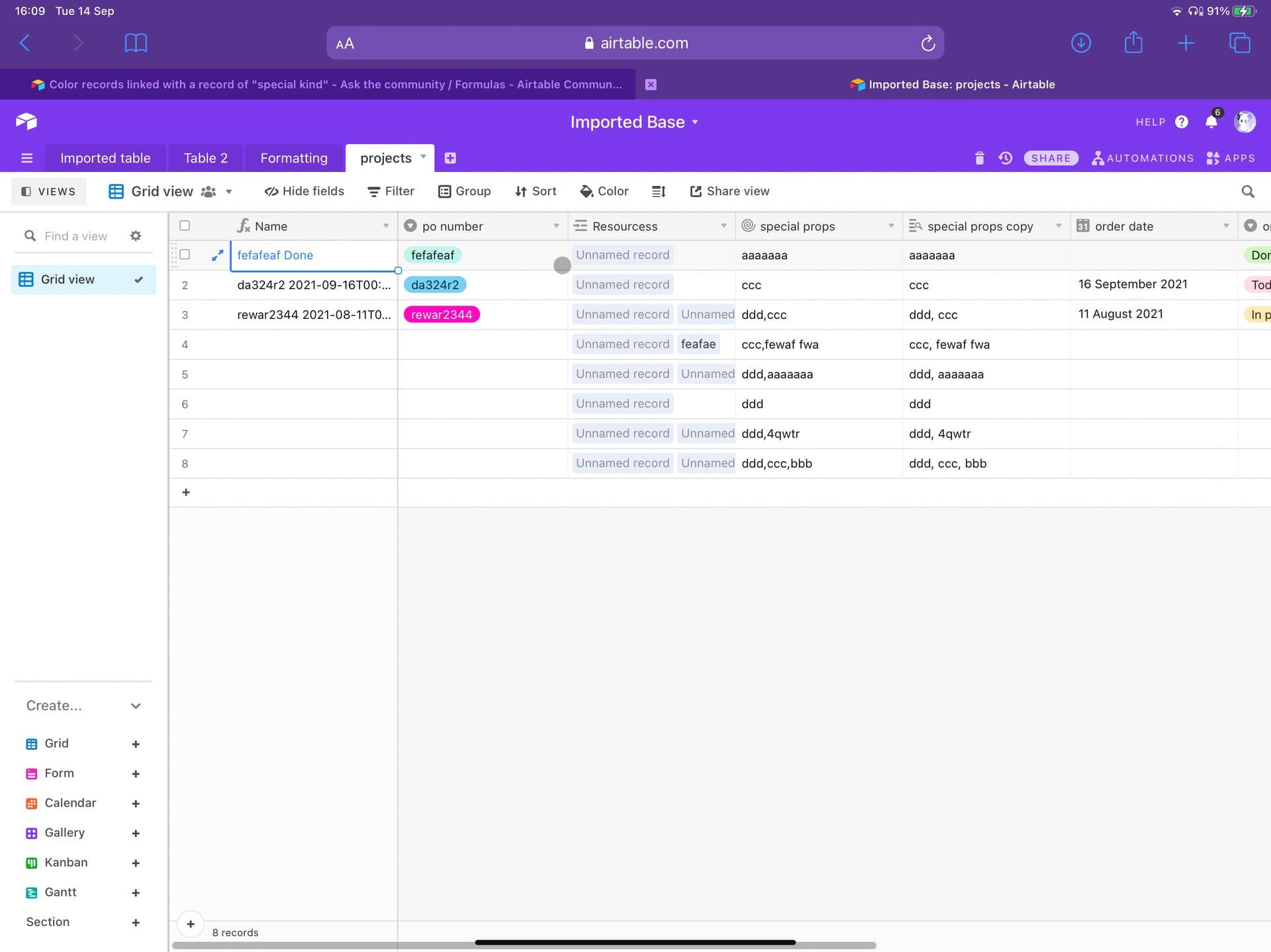

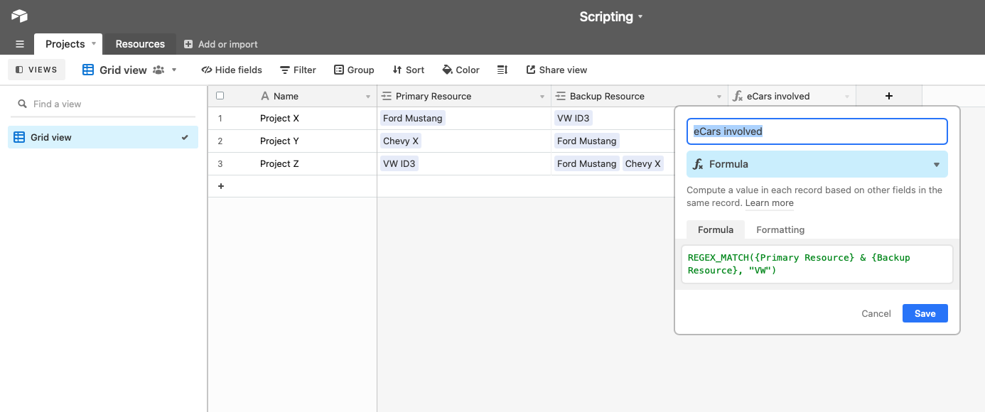

Another rolloup array or lookup reference would allow you to do so, so would a custom view and dozens of formula combinations. Personally, I’d probably just go with regex here as direct, no-nonsense queries are what it’s good for:
So, see what this does:
REGEX_MATCH(
    {ResourceAssignedColumnName}
& "" & {ResourceBackupColumnName},"(bbb)")
It should return a 1 if there’s a bbb somewhere in there and 0 otherwise.
And note that you can replace the “(bbb)” part with another field reference in the vein of “(” & DesiredFieldName & “)”, depending on whether you’re going for full auto or are simply building a dashboard of sorts and would prefer to have some agency without redoing the formulae every now and then.

I tried a bit and found that it works when the resource name has a “bbb” in it. But as it’s an attribute to the linked record I’m not sure how I can tell the Regex that it should look into the details of a record to match against.
Example: The linked resource name is “Ford Mustang”, but I want to match against the property “e-powered” of the Ford Mustang.
  • September 15, 2021

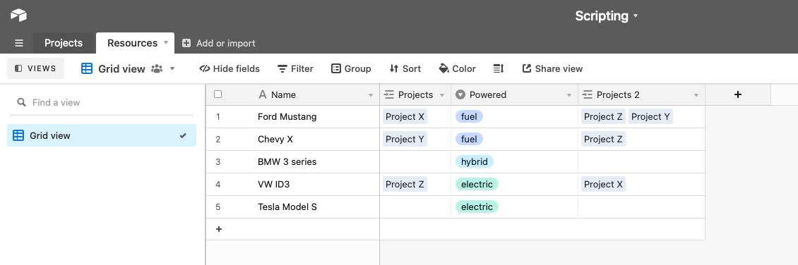

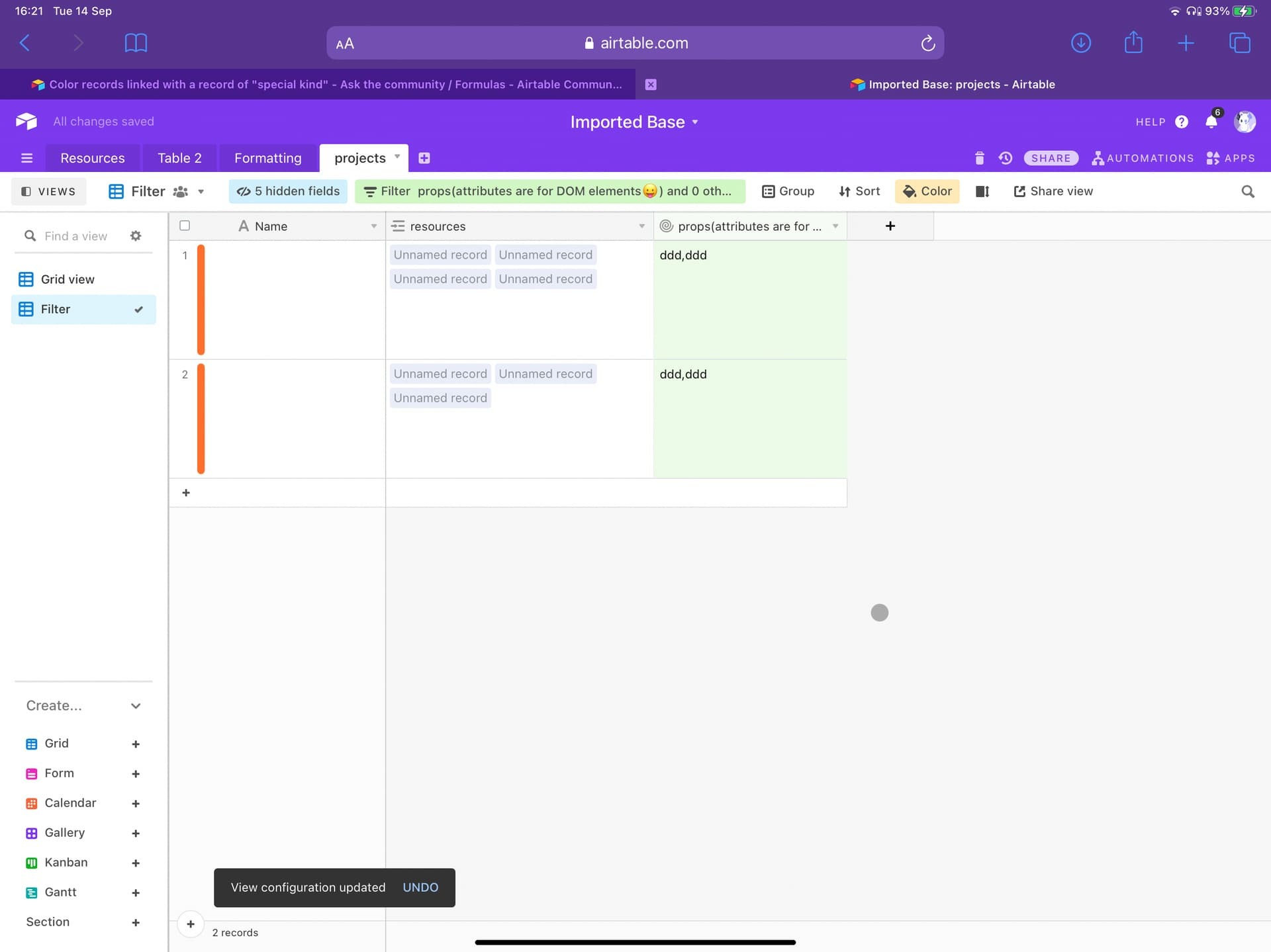

Here you can see my resources. The crucial field is “Powered”. I’m looking for electric powered cars.
here you can see my projects where I assign a primary and a backup resource.
As long as I match against parts of the resource name (here “VW”) it works.
How can I match against the powered by “electric” property of my resources?

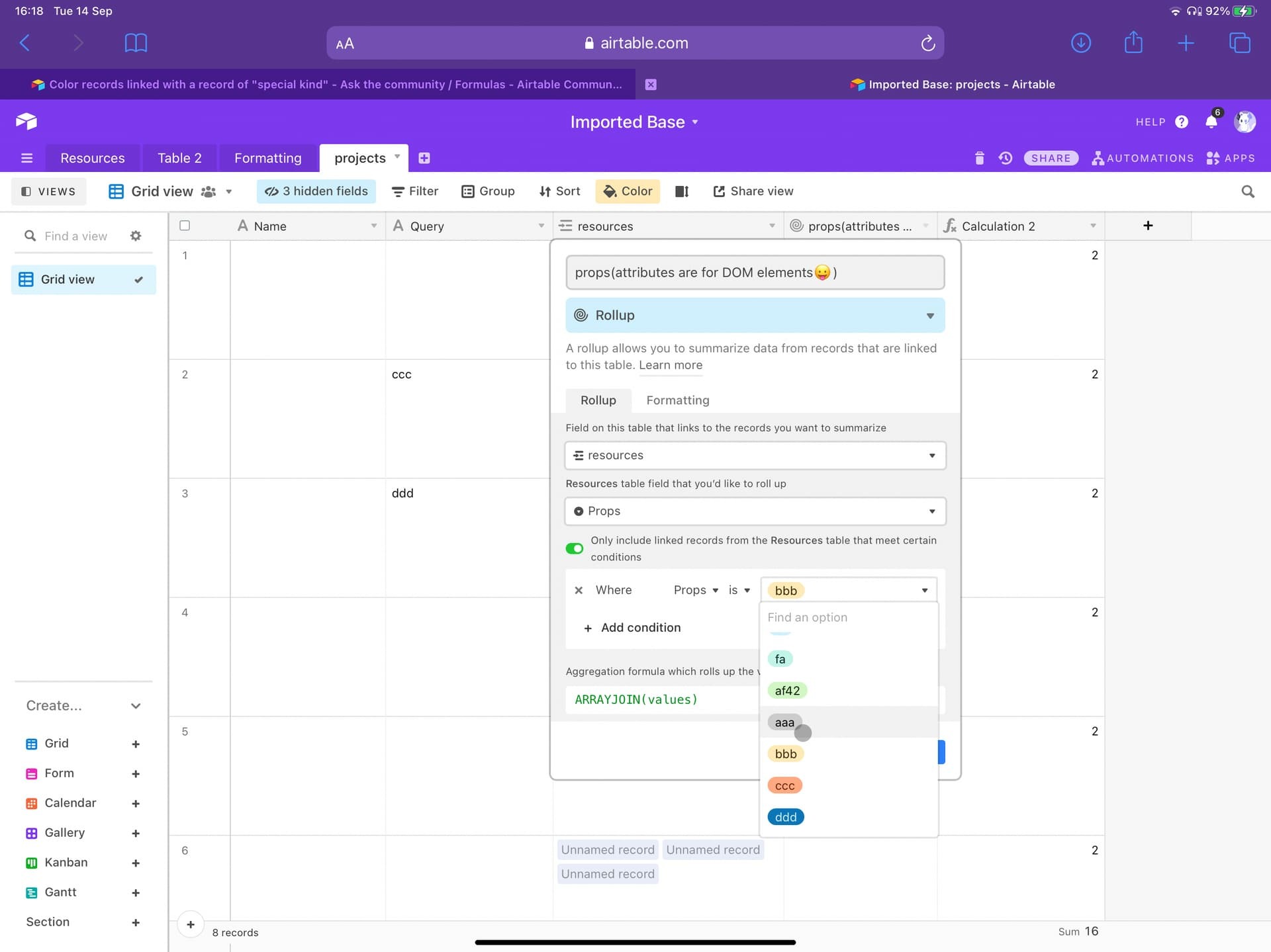

If I got that right, can’t you just add that condition over here:
If not, duplicate the field, just switch the conditions.
  • September 16, 2021

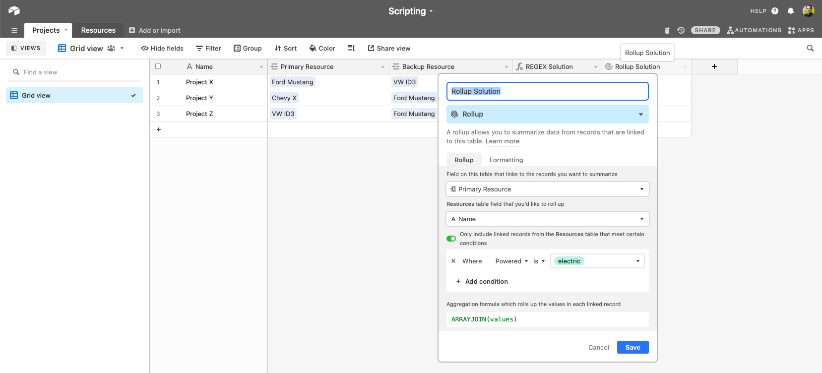

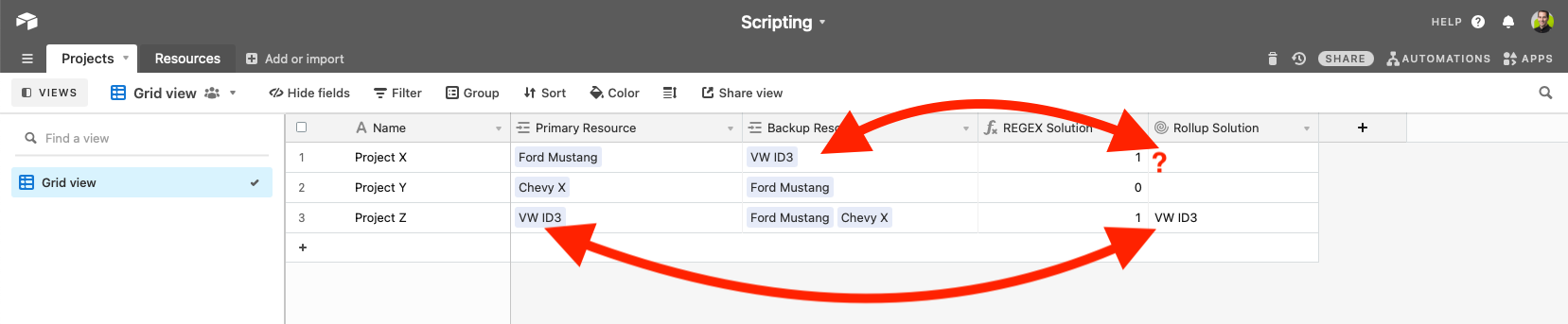

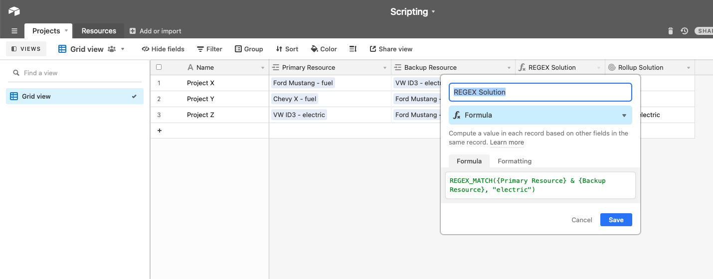

Oh yes, I’ve had that solution already. This rollup works looking on one field, but not two.
Look here: This is the solution you propose. The rollup is looking into the Primary Resource and rolls up when there is a link with prop powered electric.
The challenge now is to look in Primary and Backup Resource at the same time for a prop electric linked record. Here is an example. Find the “VW ID3” in both resource links.
I’m wondering if there is a solution using a formula?
I tried the “REGEX solution”, as you can see in the column left to the rollup. I can only make it work with a REGEX matching for “VW” here, but not the prop of the resource “electric” which would make it work for all resources regardless of a naming convention.

The only hacky solution I was able to find is using a “naming convention” on resources and then use a REGEX to match against the name.
Here is how it works:
Make the resource identifier a naming convention “[description] - [powered]” in the resource table.
Then match with the REGEX “electric” in the projects table.
What I don’t like is, that this solution does not scale well to many props.
Is there a better solution that scales?
