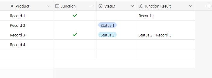

Based on the details you provided, I created the following:
Here's the formula that I used:
IF( {Junction}, IF( {Status}, TRIM({Status}) & IF( {Product}, " - " ) ) & IF( {Product}, TRIM({Product}) ) )
I'm actually a bit surprised that your formula field let you create the field with that formula you provided in your post because your Product field name is wrapped with mismatched curly/square brackets.

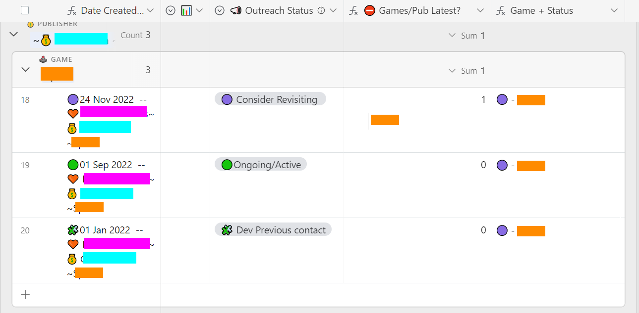

Ben, this is the result.. and what I was looking for (sensitive info covered)
but if you know how I can get it to look like this, it would be EVEN BETTER
One field that isn't visible that is a commonality amongst these records is the one that lists the junctional relationship. Mentioning that as I believe that it is an important detail to achieving the look
