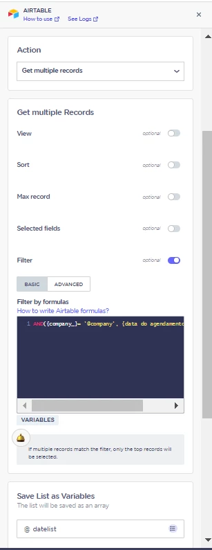

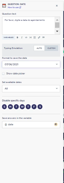

@Justin_Barrett Im using a landbot chatbot. in this bot, the client types a date to search, and then his answer goes to an airtable block that queries that date and brings back the lines that have that date filled out. however if I use the function “=“ it doesn’t work. and if I use “>=“ it lists the date that the customer entered and all the others that follow.
Could you please share a screenshot of your setup in the Landbot system, including where you have this condition entered?
The formula I’m using in the screenshot is:
AND({company_}= ‘@company’, {data do agendamento} >= ‘@date’).
It’s a mystery why the >= operator works while the = operator doesn’t. Technically neither one should work because, as I said above, that formula comparing the Airtable date field—which stores the data in what’s called a datetime—against a string representation of a date.
If an exact match is what you really want, then what you could do is use a formula that formats the Airtable date similar to the formatting used in Landbot. Try this:
AND({company_}= '@company', DATETIME_FORMAT({data do agendamento}, 'MM/DD/YYYY') = '@date')
That will compare two similarly-formatted date strings, which should result in matches for some records.

thanks for the tip. I decided to do the reverse process. I created a new column in the airtable converting the date into string, so comparing string to string I can use the “=” symbol and now it’s working.
