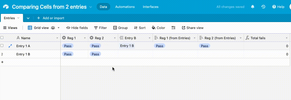

Hmm, the only way I can think of doing this is by linking the entries and using a lookup per regulation
We then use a formula field to calculate the number of fails like so:
  OR({Reg 1} = "Fail", {Reg 1 (from Entries)} = "Fail"),
  1
  OR({Reg 2} = "Fail", {Reg 2 (from Entries)} = "Fail"),
  1
Here’s the base
You can duplicate the base by clicking the title of the base at the top of the screen, then the three horizontal dots on the right, and then the “Duplicate Base” button.
  1
  1
Here’s the base
