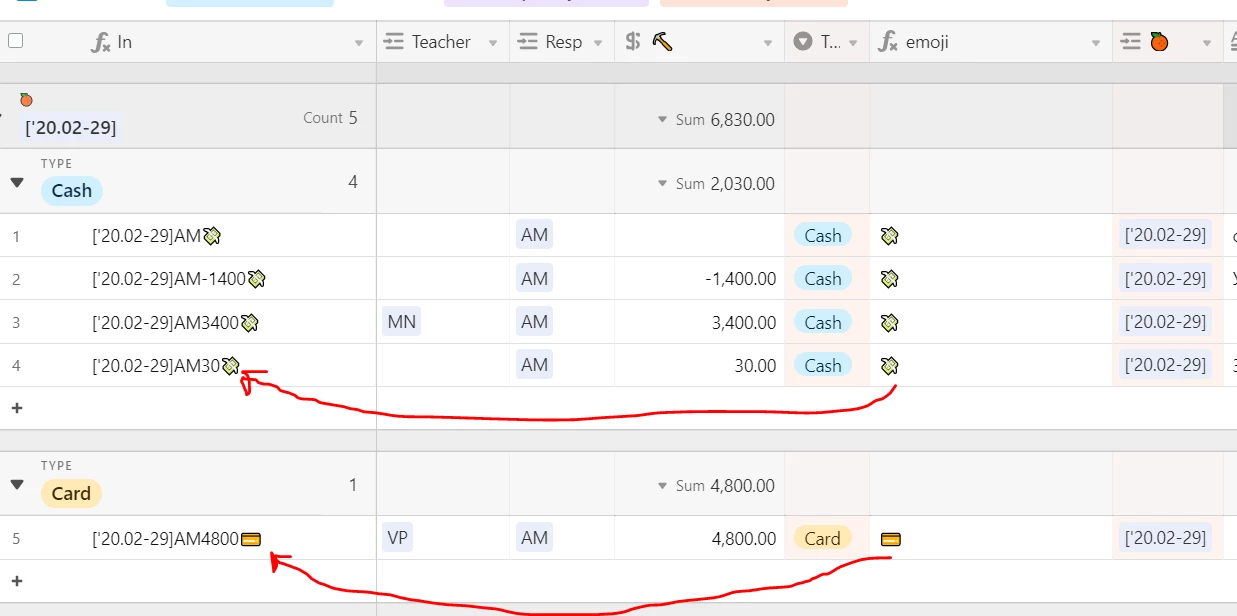

Hello, dear Airtable community.
I want to generate a unique payment ID, based on the sum, date, cashier, and the type of transaction.
Everything has been good by far, until I decided that I want to try using emojis. So, I assumed it should be a mix of CONCATENATE and IF, because I want the emoji to appear only in one field = meaning that IF it says ‘cash’ then show ‘ :money_with_wings: ’, IF it says ‘card’ then show ‘ :credit_card: ’

A separate IF function works well to produce a separate field translating words to emojis, as shown on the screenshot. But is there a way I can include the IF statement to the main concatenate field, so that a helper field is not necessary?
Absolutely, it can be in the same formula. Just concatenate it. I prefer to use the & operator to join things together because I find it easier to read than the CONCATENATE function. You can even use multiple lines.

Thanks for your reply and the IF statement!
I’m using a CONCATENATE function.

Thanks, that worked! The & operator is indeed more friendly.
My current forfmula looks as follows:
{date field} & IF({Type} = “Cash”,“ :money_with_wings: ”,IF({Type} = “Card”,“ :credit_card: ”)) &{Cashier} & {amount}
I know, that is a whole different question, but can I add the “+” sign to differentiate between negative and positive values in the Primary field? Below is the screenshot where I want the values to be more aligned - with the minus sign in place for the expenses, I want to add the plus sign as well for better aesthetics so to speak :slightly_smiling_face:

IF({amount} > 0, "+")
