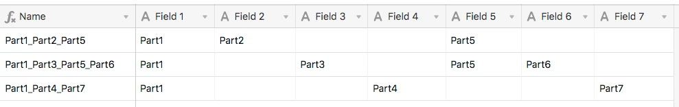

I am concatenating text in various cells. When all cells in (Fields 1-6 is filled the result is perfect.
However when data is missing from some of the Fields it generates a double underscore.
How could I avoid this nuisance ?
Formula being used:
CONCATENATE({Field 1}, “", {Field 2}, "”, {Field 3}, “", {Field 4}, "”,{Field 5}, “_”, {Field 6}, Extension)

It looks like this formula should produce only a single underscore between {Field 5} and {Field 6}.
So, it is strange that it is producing a double underscore. Do you have underscores in any of the field values?
It also looks like the formula might not be displaying correctly. Do you have asterisks * inside the quote marks? If you want the formula to show on these forums exactly as you type it, format it as a markdown code block.
Here is a concatenation formula that will concatenate seven fields, separating items with a comma and omitting commas where there are empty cells. (Note: it will not work correctly for number fields that contain zero values. That would be a much longer formula.) Perhaps you can adapt this formula for whatever symbol you want to use between items.
{field1} & IF(AND({field1}, OR({field2}, {field3}, {field4}, {field5}, {field6}, {field7})), ", ")
& {field2} & IF(AND({field2}, OR({field3}, {field4}, {field5}, {field6}, {field7})), ", ")
& {field3} & IF(AND({field3}, OR({field4}, {field5}, {field6}, {field7})), ", ")
& {field4} & IF(AND({field4}, OR({field5}, {field6}, {field7})), ", ")
& {field5} & IF(AND({field5}, OR({field6}, {field7})), ", ")
& {field6} & IF(AND({field6}, {field7}), ", ")
& {field7}

You should be able to replace the comma with an underscore.
Make sure that you have straight quotes " instead of curly quotes “”.
If {Field 1} is a given, you can get away with a much simpler formula:
{Field 1}
& IF({Field 2}, "_" & {Field 2})
& IF({Field 3}, "_" & {Field 3})
& IF({Field 4}, "_" & {Field 4})
& IF({Field 5}, "_" & {Field 5})
& IF({Field 6}, "_" & {Field 6})
& IF({Field 7}, "_" & {Field 7})

@Justin_Barrett ,
Absolutely brilliant! This is EXACTLY what I needed.
