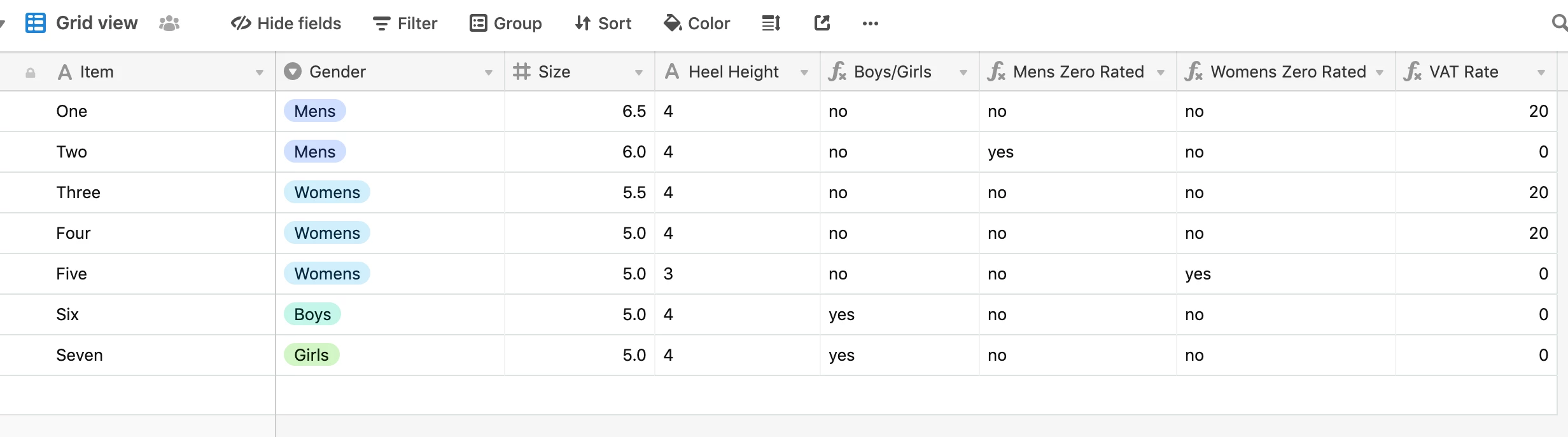

Hi @Will_Bailey - it is possible to do this in a single formula, but I find it is much easier to break this problem down into interim steps/fields before coming up with the final answer. Have a look at this:
I’ve got 4 formula fields in this table:
Boys/Girls - determines if gender is boys or girls with the formula:
IF(OR(Gender = 'Boys', Gender = 'Girls'), 'yes', 'no')
Mens Zero Rated - determines if a Mens item should be zero rated with the formula:
IF(AND(Gender = 'Mens', Size < 6.5), 'yes', 'no' )
Womens Zero Rate - determines if a Womens item should be zero rated with the formula:
IF(AND(Gender = 'Womens', Size < 5.5, {Heel Height} < 4), 'yes', 'no')
The final column - VAT Rate - then uses a formula to say if any of the other 3 columns are “yes” then use 0% otherwise use 20%, using the formula:
IF(OR({Boys/Girls} = 'yes', {Mens Zero Rated} = 'yes', {Womens Zero Rated} = 'yes'), 0, 20)
As an aside, I removed the apostrophes from the gender values as you need to escape the apostrophes in the formulas.
JB
