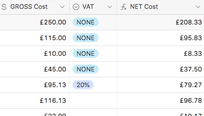

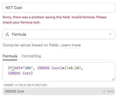

Hi Dimitris,
Thank you so much for your reply.
Definitely good to know the capitals matter too!
Unfortunately it's still saying I have an invalid formula. I've attached a couple of screenshots below of the table. I currently have GROSS Cost as a Currency field rather than a Number field, is that ok?
In the screenshot the Net cost formula is currently set to just calculate as if the VAT is 20%.
Thank you
Dimitris_Goudis
Forum|alt.badge.img+20
Hey @cevison2,
The error in your formula is the missing closing parenthesis ")" at the end.
PS Currency field and number field are the same data type number so this will never effect you
Thanks
Yours sincerely,
Dimitris Goudis

Amazing!
That's fixed it, I must have missed that when I copy pasted and just didn't notice. Thank you so much!
