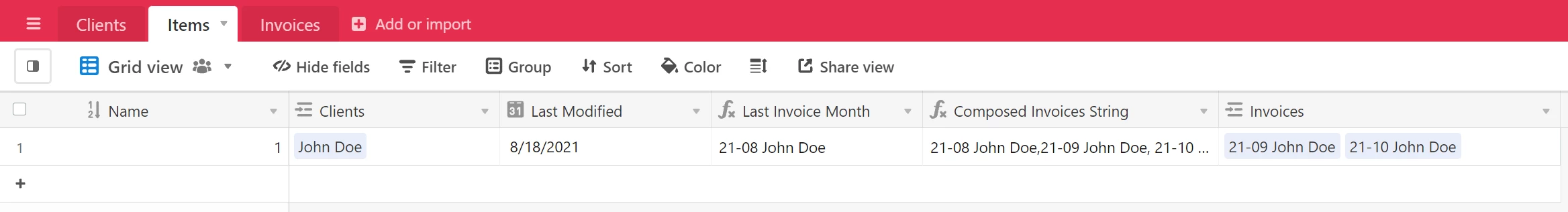

Have your Items table look like this:
I used a regular date field for {Last Modified} for testing purposes, but you’d likely use a Last Modified Time-type field. {Last Invoice Month} converts the {Last Modified} date and Client name into a unique string that matches the structure of the primary field for the Invoices table. The {Composed Invoices String} field takes whatever currently linked invoices there are and adds the {Last Invoice Month} value to the list if its not already there; the formula I used for that is:
   Invoices,
   IF(NOT(FIND({Last Invoice Month}, Invoices)), {Last Invoice Month} & ",") & Invoices,

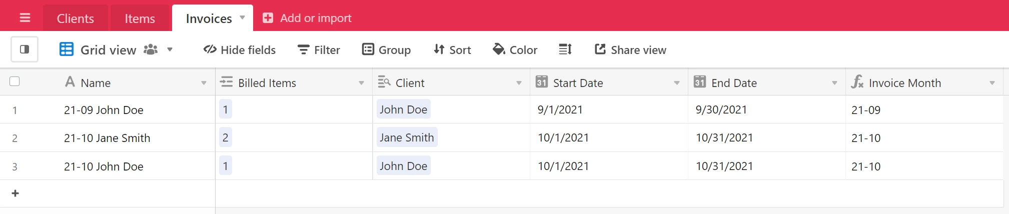

I set up the Invoices table like so:
Then I set up an Automation to trigger when an Item record’s {Last Modified Month} field changed. The Automation includes a simple Update Record step that copies the value of {Composed Invoices String} into the {Invoices} link field.
The end result is that every time you update an Item, if it hasn’t already been associated with an Invoice record for that month it gets linked to an Invoice record for this month. So long as the Invoices’ table’s primary field isn’t a formula, a new Invoice record will be created if it doesn’t already exist.
