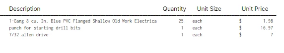

Thanks Cherry, but yes it is stored as a number formatted as currency in it's original field. The reason I ask about converting to a string is that my problem goes quite a bit deeper. I have a Page Designer document that prints all lines linked to a parent-level purchase order. To do this I lookup the linked currency data, which comes a cross as an array. I then use this formula to create the field that Page Designer prints to my document:
SUBSTITUTE(ARRAYJOIN({Unit Price}), ",", "\n")
The problem is that ARRAYJOIN necessarily converts it to a string and my formatting is lost. See the attached picture for the results on my PO document. I'm using another field altogether just to get the dollar signs to print.
