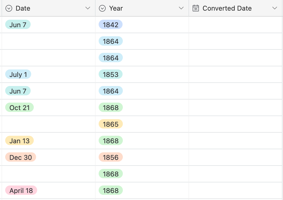

Hello guys,
I am an extreme beginner,
I have my data as a date in the incorrect format, I'm looking to auto-convert each figure into a specific "date" category.
Can someone please explain how to do so?
Thank you so much in advance

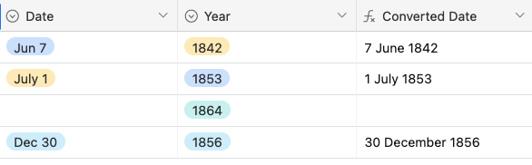

You'll need to use a formual field with `DATETIME_PARSE()` and the correct format specifiers.
Here's something to start you off:
Formula:
IF( AND( Date, Year ), DATETIME_PARSE( Date & " " & Year, "MMM D YYYY" ) )

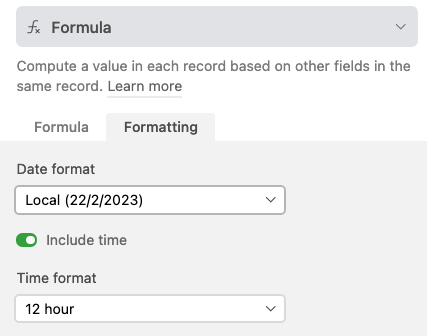

That worked! Thank you so much. Currently, it has the time at the end which is unnecessary, how can I remove this with the script you have given me above?
Ah to do that you'd just need to modify the settings of the field itself and toggle "Include time" off
