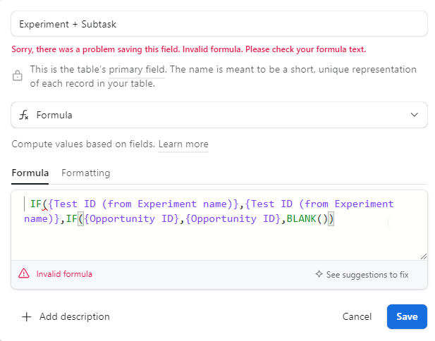

Hi Mike,
That doesn't seem to work?

You missed second closing bracket. But in general,  I wouldn't recommend to use BLANK() in Airtable, it just raise the level of chaos in formula and probability to make mistake.

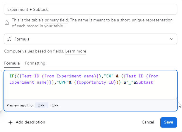

Hi @Alexey_Gusev that seems to work better! The only thing is that I need the field to be blank when there FIELDB is empty.
  • January 2, 2025
screenshot to clarify: I'd like it to not say "OPP" if there is no "Opportunity ID" is provided
"I need the field to be blank when there FIELDB is empty. " - my logic was "It displays FIELDB so when it is empty, it displays nothing".

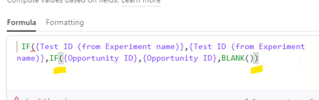

In you clarified example, use @Mike_AutomaticN solution. Just pay attention that when your cursor is on  closed bracket the formula editor shows you that it 'belongs' to the second IF.
While first IF bracket remains unclosed and formula editor marks it by red. So you need to add another closing bracket in the end.
You can leave BLANK() as is or just remove it. Airtable formulas are flexible and allow condition like
IF(Field, Field) without third parameter
