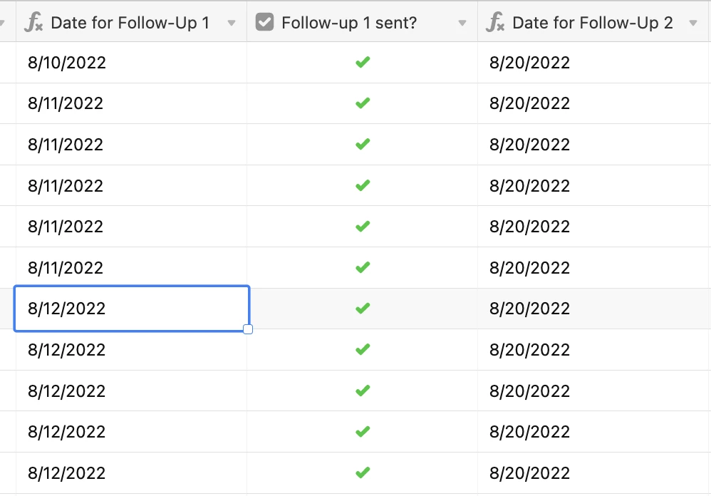

I would like to create a new static date when a checkbox is clicked. It should be [day the checkbox is clicked] + [X Days].
I’m actually using
IF({Follow-up 1 sent?} = 1, (DATEADD(TODAY(),2,"days")),BLANK())
However the Today() function keeps updating the date to … today. I’d like the newly created date to be static and not be incremented every day by the TODAY() function.

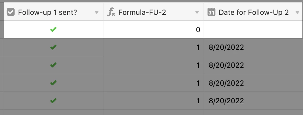

Understood.
I’ve created a new formula field with updated formula but it doesn’t update the date.
IF({Follow-up 1 sent?} = 1, {Date for Follow-Up 2} = (DATEADD(TODAY(),2,"days")), {Date for Follow-Up 2} = BLANK())
Understood.
You could use your original formula from your original post, but I would scrap that formula and just use the simplest version of what you need, which is this:
Then, hide that formula field because you don’t need to see it.
Then, setup an automation that triggers when you check the checkbox. Set the automation’s action to update your brand new date field (which it doesn’t look like you have created yet) to be the formula field.
  • August 22, 2022
Thank you. Its working.
