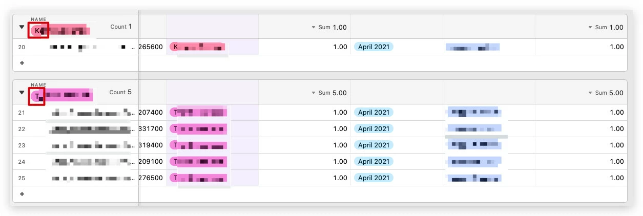

I have a question that I can’t seem to wrap my head around, so I would love to have your input. Let’s take a look at the following screenshot:
As you can see, I group records based on a name. In this case, we have “K” and we have “T”.
I would love to create a sum of the points for each person. So K would have 1 point, where T would have 5 points. There is indeed already a SUM, but I’m not able to sort on the SUM of each group (if I can, please let me know how, meaning that T would be on top of K).
So, I would like to create a field that is able to calculate the SUM from all the records for each name separately. I would not mind if I would see that same result in each record, but the idea is to create a scoreboard, where the highest sum of points for each person is on top (currently, when I sort, it just sorts on the individual point).
Is this possible, and if so, how would I go about this?
(Basically, I want to do some kind of count if on each name separately and on each month separately, although the month parameter I can probably tackle with a view)
Thanks so much!

The sums that you are currently seeing are in the summary bar. Values in the summary bar are not accessible anywhere else. You cannot use them in formulas and you cannot group based on them.
One option is to move your {Name} field (and possibly other fields with repeated information) to a new table and connect the tables with linked record fields. You can then use a rollup field to produce your sum in the linked table. You can then pass that sum back to this table using another rollup field, and then group on the sum. The process is actually less complicated than it sounds.
