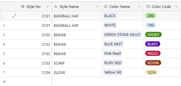

Thanks for your suggestion. I'll try to clarify I’d like a formula to create a number for all of the same styles.
For example, there may be three records for one style, each with its own color.  I’d like the formula to recognize the style is the same and give it the same number.  But on the forth record that’s a different style, the formula would assign another number.
The below I did manually, but see how the baseball hats all have the same style no and it counts up when there is a different style.

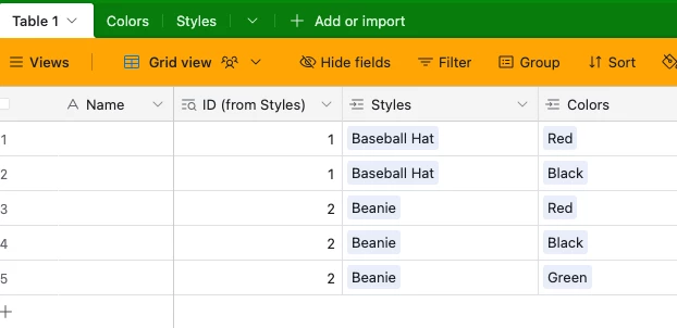

What if you converted the ‘Style Name’ text field into a linked field to a new table called ‘Styles’ instead?  Then you could put an autonumber field there and then pull it over via lookup like so:
Hi Adam,
Thanks for the suggestion.
I think that could work.  We may have more that one baseball hat but I bet this could still follow your suggestion with whatever the style.
Thanks!
