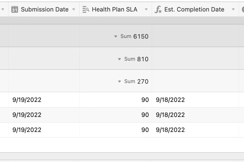

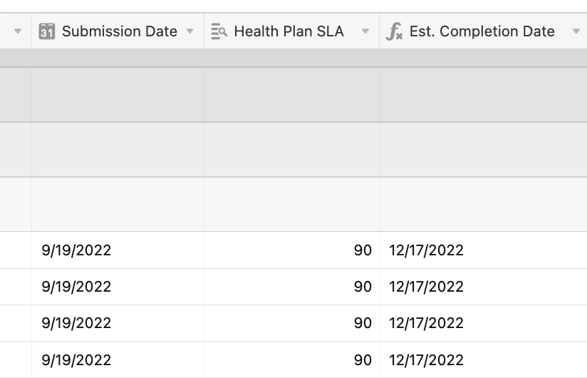

Thank you, Adam! The formula is working now, however, the date is still slightly off. It is returning a date that is one day ahead of the expected SLA. In the attached screenshot, the submission date is 9/19/22. With a 90-day SLA, it should return a date of 12/18/2222 but we're getting 12/17/22.

Hmm, could be a timezone issue; may I know what timezone your formula field's set to?
Here's some screenshots of my attempt at replicating what you're facing:
The timezone would be GMT-5 (EST)
Yeah, once you chage the formula's timezone to match the original date field's timezone it should work as expected I believe
Thank you! That fixed it.
