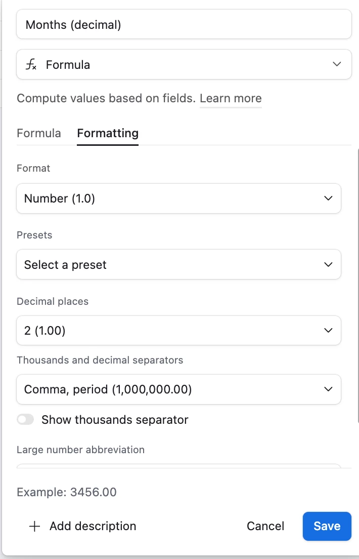

Oh yes ​@KenD when I said months/30 I actually meant days/30.
In short, the formula you will want to use is the following:
DATETIME_DIFF({Date}, TODAY(), "days")/30
You will want to set the formatting to include decimals for sure -see screenshot below.
Not really needed I believe, but you could also have your formula include the rounding, as shown below:
ROUND(DATETIME_DIFF({Date}, TODAY(), "days")/30, 2)
