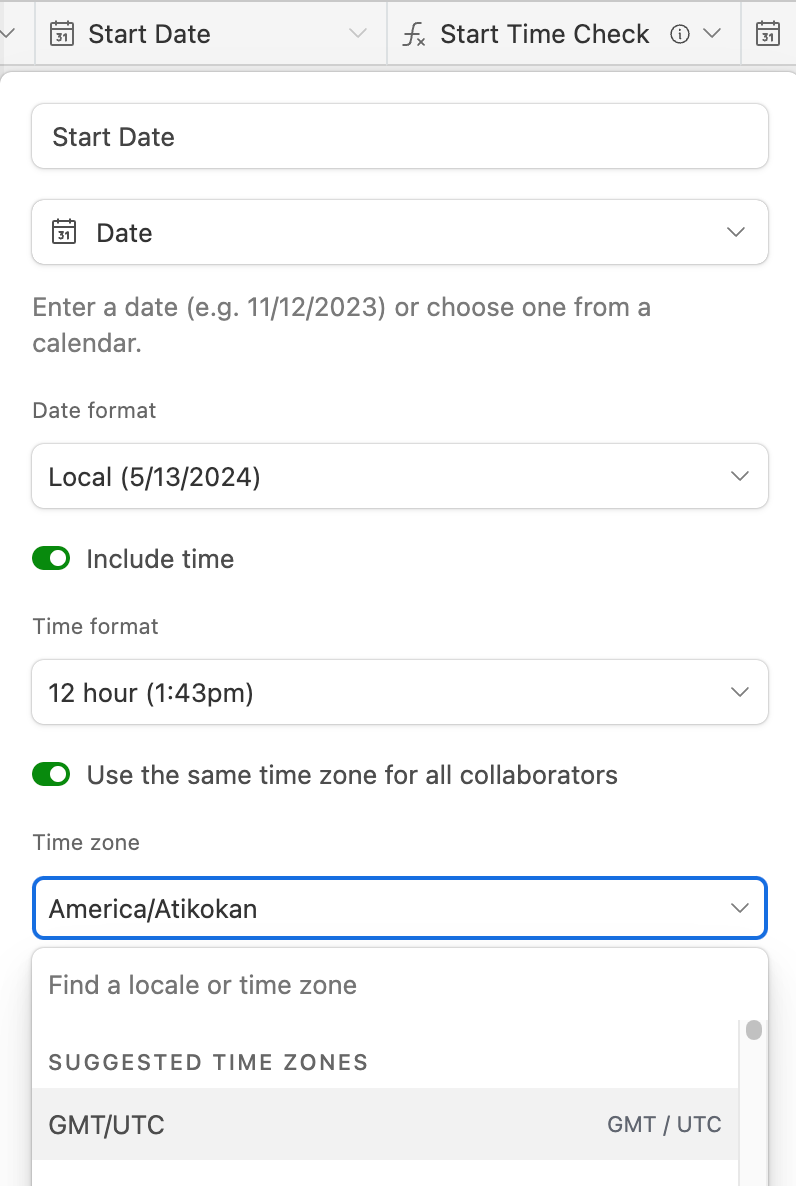

This is helpful, thank you!  A couple of other questions stemmed from your response.
1. If all times are read in GMT by the Airtable automation, then should I just set all my times to be in GMT as to not confuse myself (see image below), and when I need to insert a time that is, for example, in EST, I should convert it to GMT first?  (i.e. if the time I need to put into airtable is 8:30am EST, I should first convert it to GMT, so 12:30pm GMT?)
2. Regarding your comment about NOW() being inaccurate - my cell needs to have both Date and Time.  Is there any workaround for using NOW() if that's the case, or am I just best off using the code you provided and using NOW()?

Another issue I'm experiencing related to this @kuovonne .  It seems as though the formula you provided is triggering when the Start Date is before the time in CST (which is where my computer is located at this time).  I would have thought it would be triggering for either EST because that's what the Start Date cell is set up as, or in GMT, as that's what Airtable reads.
I usually set fields to show local time and display the timezone because that is easiest for me to use. I set fields to show the same timezone when people across different time zones need to know the time in the specific timezone. Note that formula fields that result in date/time values can also be formatted for different timezones and the default might not be what you expect.
As for the formula changing values when you do not expect, there are too many variables at play, including whether or not the base was open at the time of change. If the base was closed, NOW() can be off by an hour or more.
