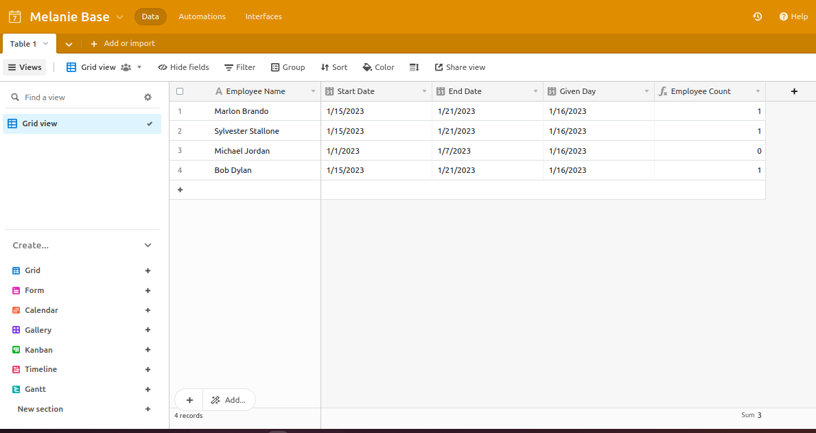

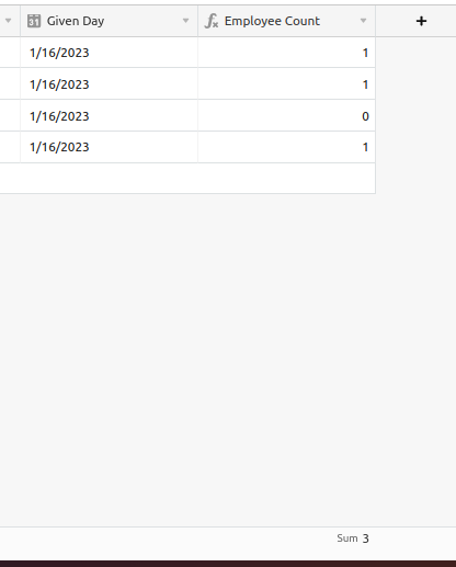

Which will give you this result :
To use it, you have to change the dates in the {Given Day} field to the one you want to test. In your case, set the given day date to March 1 and look at the bottom of the window, Airtable calculate the sum for you and shows 3 employees were working on the given day, (1/16/2023 in my table).
So you simply have to change the date of the {Given Date} to count them.
