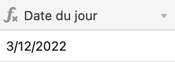

I configured my date format to European on Airtable, however, when I send this data to Integromat and making a Google Sheet template, it reformats the date in US.
Date on Airtable (03/12/2022) :

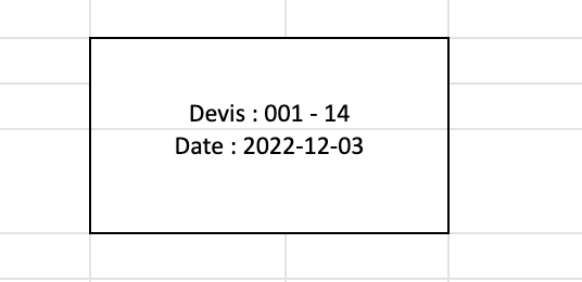

Date format received by Integromat (2022-12-05, yes I know is not the same date :p) :
Date on the template :
Do you have any idea why the date format changes on export?
Do you know any way to circumvent this?

The date formatting in Airtable is for display purposes only. It does not affect how data is sent to Integromat. Under the hood, Airtable dates are stored as ISO strings.
Some options to try…
Use an Airtable formula field to format the date as a string with DATEtIME_FORMAT()
Have Integromat parse and format the date.
Set the date formatting options in your spreadsheet.
