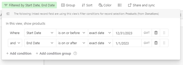

To filter for projects that were active during a FY range, try this logic:
Project start date is on or before FY's end date AND Project end date is on or after FY's start date
Example for 2023:
Hope that helps!
-Stephen

Hmmm, thanks. That way only works for projects that don't carry across fiscal years. For example, I want to be able to know how many projects were active during any given time/date parameter. Does that make sense?
This logic supports any date range. For example,
All projects active during the start of 2023 through the end of 2025:
Project start date is on or before 12/31/2025 AND Project end date is on or after 1/1/2023
All projects active during the 2nd half of 2023:
Project start date is on or before 12/31/2023 AND Project end date is on or after 6/1/2023
All projects active during the 2nd half of 1990 through 3rd quarter of 2017:
Project start date is on or before 9/30/2017 AND Project end date is on or after 6/1/1990
Can you please provide an example where this doesn't work? 🙂

Yes, you're right! That will work. Thank you!
