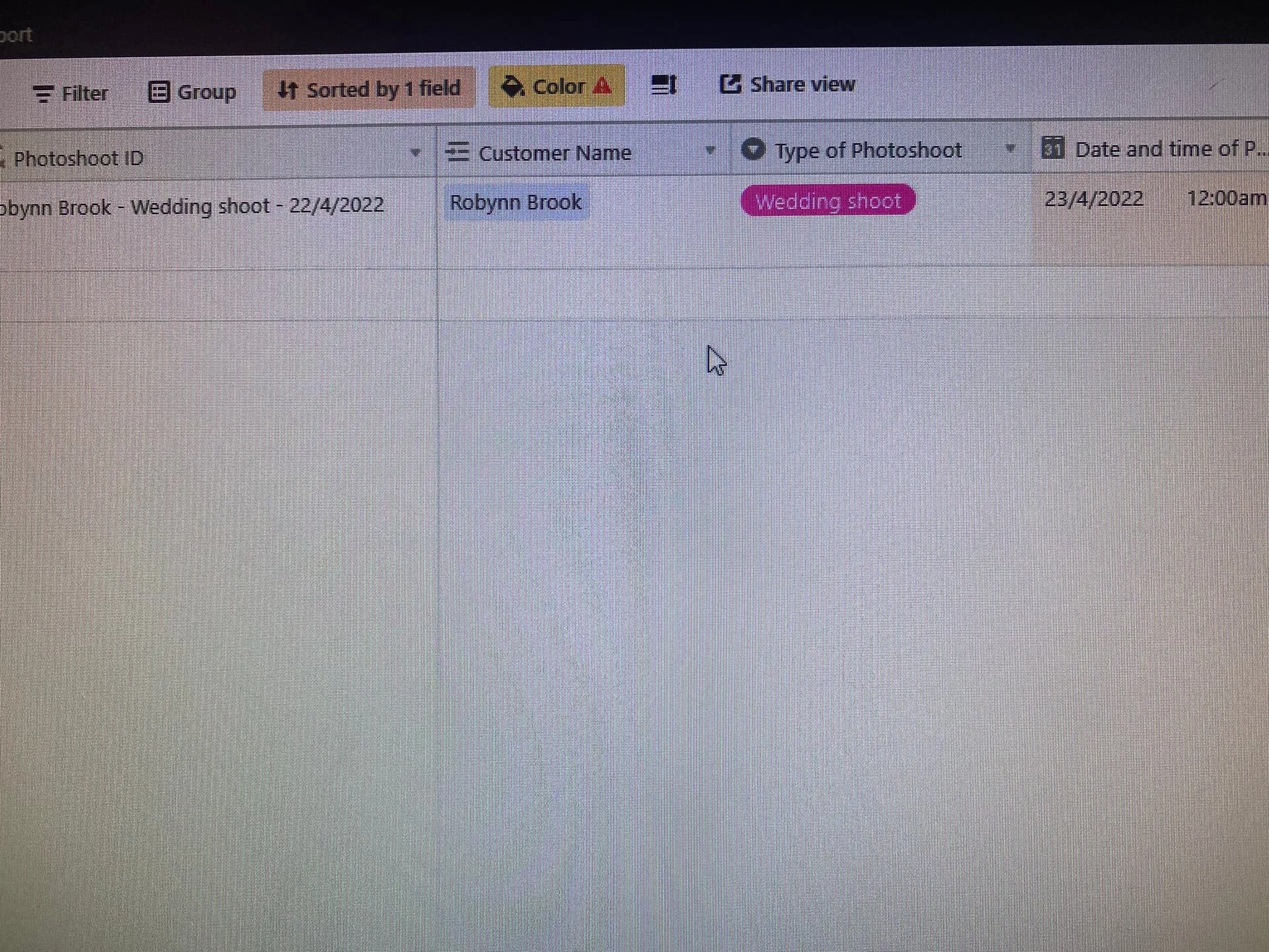

I have the following formula in my table ID column, which works great, it puts together the customer name, date of photoshoot and type of photoshoot. Leaving it blank with no error message until the data is entered, but for some strange reason the date says 23/4/2022, but the ID cell puts it together as 22/4/2022 instead. See photo……
IF(OR({Customer Name}="",{Type of Photoshoot}="",{Date and time of Photoshoot}=""),"",CONCATENATE({Customer Name}," - “,{Type of Photoshoot},” - ",DATETIME_FORMAT({Date and time of Photoshoot}, “D/M/YYYY”)))

It is a time zone issue. You need to use SET_TIMEZONE with DATETIME_FORMAT
See the formula field reference for more info.

Hey @Keith_Landale
Here’s more info on using DATETIME_FORMAT AND SET_TIMEZONE
so your formula will look something like this:
DATETIME_FORMAT(
  SET_TIMEZONE(
    Date, 'America/Los_Angeles'),
  'M/D/Y h:mm A'
Here’s a list of timezone specifiers and examples
