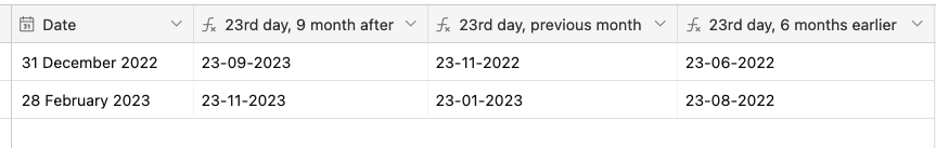

Hi there,
Wondering if anyone could help me with a couple of formulas.
I have an existing date field (DD-MMM-YY) and I want to create deadlines from this field as follows:
1.  23rd day of the 9th month after this date; example - where source field is 31-12-2022, formula should result in 23-09-2023 and for 28-02-2023, formula should result in 23-11-2023.
2.  23rd day of the previous month; example - where source field is 31-12-2022, formula should result in 23-11-2022 and for 28-02-2023, formula should result in 23-01-2023.
3.  23rd day of the month that is 6 months earlier; example - where source field is 31-12-2022, formula should result in 23-06-2022 and for 28-02-2023, formula should result in 23-08-2022.
For automations I would like the resulting dates to be in local format and up to now have been creating a secondary field using the DATETIME_FORMAT formula but wonder if there is any way to incorporate the DATETIME_FORMAT formula into the original DATEADD formula to limit the number of extra columns.
I hope this makes sense and many thanks in advance to anyone willing to assist.
Siobhan

I've put something together here for you that should do what you need, and you can duplicate it to your own workspace to get the formulas
I assumed that the format you wanted it in was the one you had in your post, but in hindsight I'm not too sure.  Let me know if it's something else and I'll see what I can do!

Thank you so much for the examples and the expected output, it makes helping so easy!!

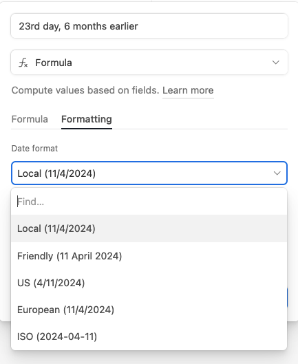

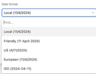

  • April 18, 2024
Thanks again for this Adam. It seems that the resulting formats are not recognised as dates and so sorting by date order in the fields generating by the formulae is not possible.
Any way around this?
I'm afraid not, once we use DATETIME_FORMAT to convert them into "DD-MM-YYYY" they become text.  If we want to be able to sort them by date order we're going to need to remove the DATETIME_FORMAT bit and use one of the default date display options:
