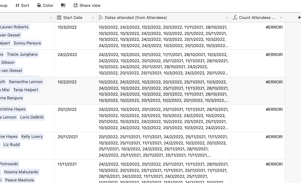

I’ve used this formula:
MIN(
VALUE(DATETIME_FORMAT({Dates attended},‘DD-MM-YYYY’))
To understand what the minimum date is, however when {dates attended} is a string of dates, i.e. 12/11/21, 07/12/21, 28/01/22. It produces an error.
I’m going to attach some views of the database, would be curious to see your thoughts!
View of Attendees (The events they have attended)
View of Events (and the attendees that attended)
These are both linked together.

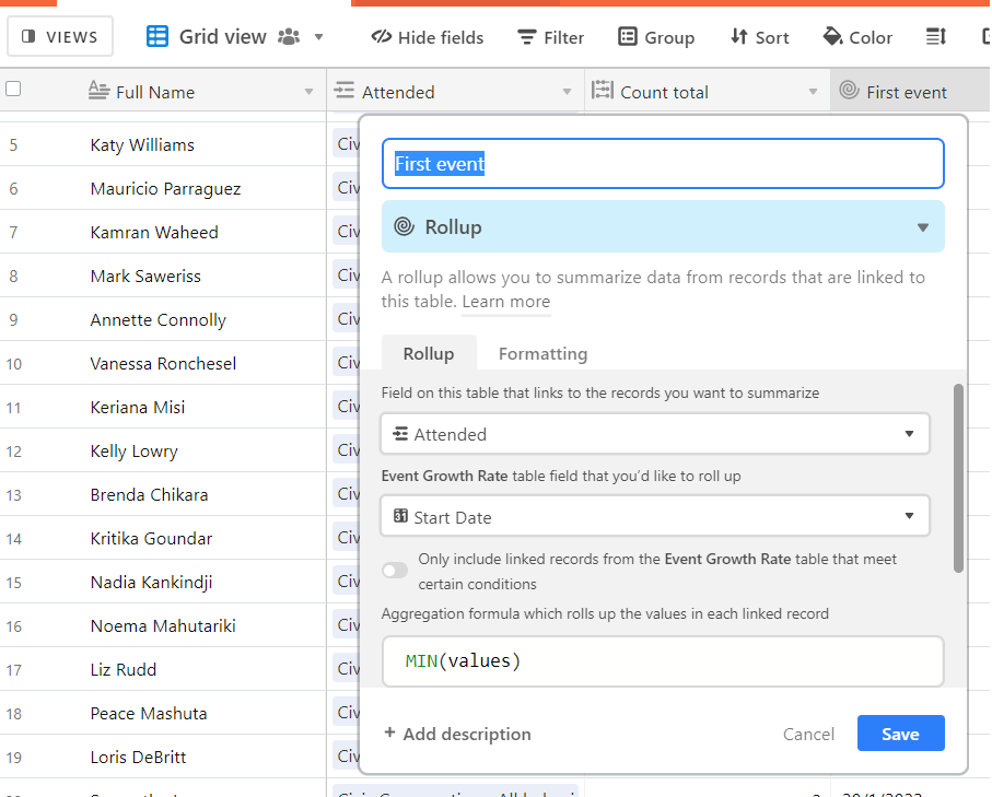

I think maybe all you need is to use a rollup instead of a lookup for {First event}, like this:
That will give you the date of the first event each attendee attended. Is this what you need?
