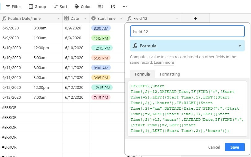

I am having trouble with a formula. I need to bring back an exact minute time but cannot figure out how to make it read the minutes in this equation. Can someone help?

the problem is I don’t know where to plug in the MINUTE({Date Field}) in the nested If statement above to make it calculate correctly.
What are you trying to accomplish with your formula?
I was trying to bring the date column and start time column together in a formula where it returned the exact dates and times in a single column that I had input into two. It is quicker to input data in times and dates in separate columns that to have to stop and use the calendar input buttons. But I found a solution from another user on another platform that worked. Here is the formula he provided. Thanks!

That formula actually isn’t correct — you’ll want to remove the DATEADD function, since you’re not adding anything.
This is the formula that you will want to use, and I also removed CONCATENATE as well to make it even easier to read:
DATETIME_PARSE((Date & " " & {Start Time}),"YYYY-M-D h:mma")
