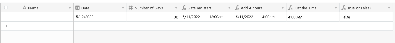

Hello Thank you for this feedback,
I am attaching a photo of the table
Field 1 - calculates the fields ;Date morning Start and number of days
Field 2 - calculates Date morning Start, + 4 hours
I would like fields 1 and 2 to combine the two formulas
On the field - Calculating Morning and AM copy the form does not work IF({Date morning Start} = ‘09:00’, ‘true’, ‘false’)
Thank you

OK, here you go
Date AM Start
DATEADD(Date, {Number of Days}, 'days')
Next
DATEADD(DATEADD(Date, {Number of Days}, 'days'),4,'hours')
Get the time
DATETIME_FORMAT(DATEADD(DATEADD(Date, {Number of Days}, 'days'),4,'hours'), 'LT')
Finally
IF(DATETIME_FORMAT(DATEADD(DATEADD(Date, {Number of Days}, 'days'),4,'hours'), 'LT') = "9:00 AM", 'True', 'False')

Great, thank you !
everything works :grinning: except grinning: true or false I attach the link to the table
Forum|alt.badge.img+16
My apologies. I misread your post. In my formula the True false is looking at the “Just Time” field. You should be able to adjust it to pick up the Date am Start field. Do you want to give it a try? If you cant get it, I can fix it tomorrow.
I tried but without success thank you for your help

IF(DATETIME_FORMAT(DATEADD(Date, {Number of Days}, 'days'), 'LT') = '9:00 AM', 'True', 'False')
Cela fonctionne ! Merci beaucoup bien cordialement :grinning:
