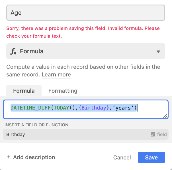

I tried that, but I get the error message.
Using: DATETIME_DIFF(TODAY(),{Birthday},‘years’)

Are you using the correct quotation marks?
DATETIME_DIFF(TODAY(),{Birthday},'years')

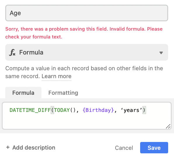

Ok, so it worked with this formula putting the date first: DATETIME_DIFF({Check-out}, {Check-in}, ‘days’).
But for this formula: DATETIME_DIFF(TODAY(),{Birthday},‘years’) and DATETIME_DIFF(TODAY(), {Birthday}, ‘years’)
I got the attached error message.

It’s because, as @Mohamed_Swellam pointed out above, you are using stylized quotation marks around the word years. Airtable only recognizes straight quotes, not curly quotes.
