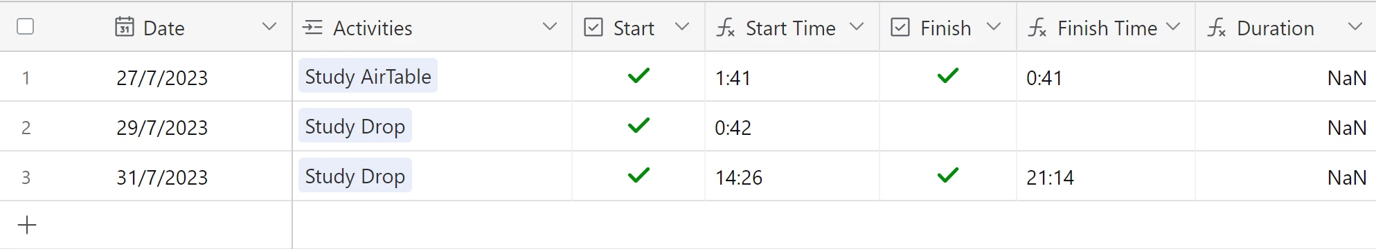

Hey there.
I'm trying to get the duration of an activity by calculating the difference between 2 timestamps.
These timestamps are the results of a formula that shows the time as a box is checked at the start of the activity and another, at the end.
The formula in Start Time and Finish Time fields are:
IF({Start}=1,DATETIME_FORMAT(SET_TIMEZONE((LAST_MODIFIED_TIME({Start})), 'America/Sao_Paulo'),'H:mm'),0)
IF(Finish=1,DATETIME_FORMAT(SET_TIMEZONE((LAST_MODIFIED_TIME(Finish)), 'America/Sao_Paulo'),'H:mm'),0)
Resulting this:
The formula in Duration field is:
DATETIME_DIFF({Start Time},{Finish Time},'minutes')
And the result is "NaN" as seen above.
So the question is: how do I make it show time difference of the activity? 🤔 🤔
Any help is greatly appreciated.
Best vibes.
Ed.

Hi @Ed12 ,
The return value of DATETIME_FORMAT() is a string value.
Therefore, it is not treated as DATETIME and cannot be calculated.
How about this?
IF(AND({Start},{Finish}), DATETIME_DIFF(LAST_MODIFIED_TIME({Finish}),LAST_MODIFIED_TIME({Start}),"minutes") )
