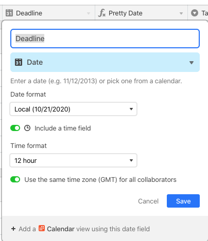

:thinking: …hmmm… this seems like it should have been consistently off by a day if the time was after a certain time of day, because I’m pretty sure you are right about this:
Try this - open up the Field settings for the Start Time field and check the “Use the same time zone…” option:
That usually fixes issues with inconsistent dates/times being pulled into formulas:
If you are actually collaborating across time-zones with other people, however, this may have adverse affects. It’s easy to change back, so I’d give it a shot and see if it’s a workable solution.

Eureeka!
Thank you so much, Jeremy.
All my collaborators are in my same time zone.
