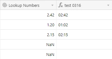

I may be boring,
But do you know why does it show me numbers that are ending with “0” like this
Formulas I used:
Lookup Numbers > AVERAGE(values)
test 0316 > IF(ISERROR(AVERAGE({Lookup Numbers}))=0, DATETIME_FORMAT(DATETIME_PARSE({Lookup Numbers},‘hh:mm’),‘hh:mm’,BLANK()))
Had to use ISERROR because of error and NaN.
