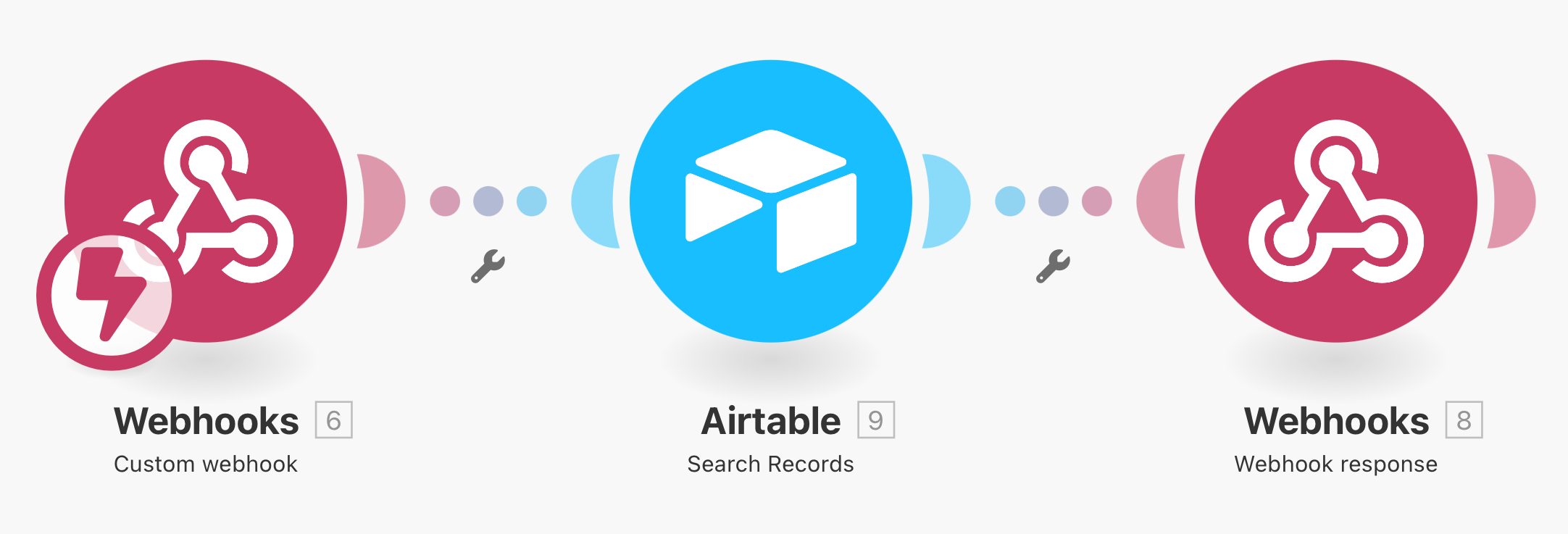

You can create a custom redirect by using Make’s custom webhooks and custom webhook responses.
You would add the “type number” as a parameter to your webhook URL, and then you would search your Airtable base to get the record ID, and then your webhook response would redirect the person to the real URL by using a 303 Redirect command.
See screenshot below for the basic setup of this scenario in Make.
