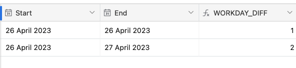

You can use `WORKDAY_DIFF()` for that I think:
WORKDAY_DIFF(Start,End)

Yep, that's it. Thanks!

how if the start date and end date falls in different month for this case? Thank you in advance.
@CTSI think it'll work fine even if they have different months
