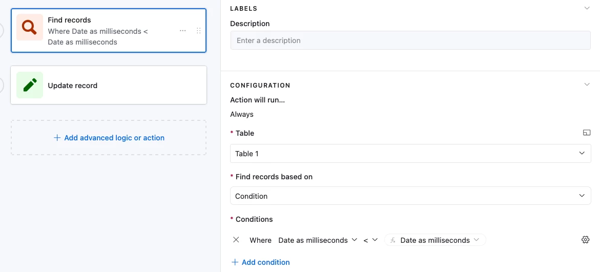

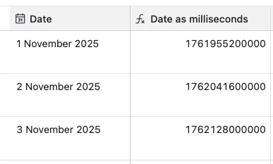

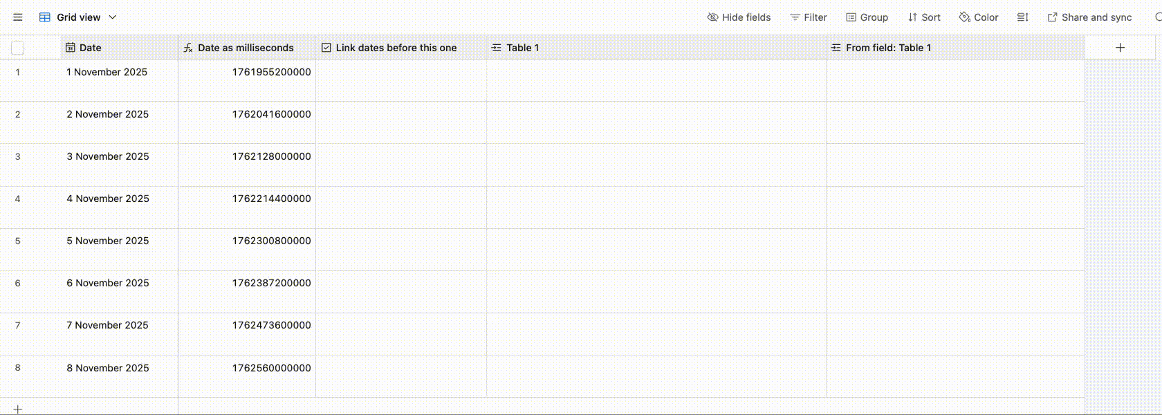

Try adding a formula field that converts the dates into milliseconds and filtering off of that instead.  I’ve set it up here for you to check out
Here’s the formula:
DATETIME_FORMAT(Date,'x') + 0
And that converts it into a number that you can then use in Find Records:
Here’s the formula:

Hello ​@TheTimeSavingCo  / Adam,
Thank you so much for the milliseconds solution - it worked brilliantly!
Your approach unlocked exactly what I needed. Here's what I have been able to build with it:
The Challenge:
  • Tracking social media metrics monthly and needed to automatically calculate month-on-month growth for each expert.
  • Required linking each record to all previous records (same Contact/Platform) but ONLY where dates were earlier.
The Solution (thanks to you):
  1. Formula field: Date as Milliseconds using VALUE(DATETIME_FORMAT({Date Recorded}, 'x'))✅
  2. Automation Find Records: Filter where Date as Milliseconds < trigger's milliseconds value ✅
  3. Rollup: Get previous month's follower count from linked records using MAX date
  4. Growth % Formula: Simple division formatted as percent
Result: Every new record automatically links to all previous months, rolls up the immediate previous month's data, and calculates growth % - completely automated!
The milliseconds conversion was the key insight that made dynamic date comparisons possible in automations. Brilliant workaround!
