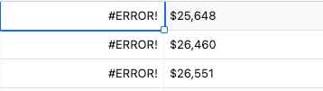

1. Im dividing the "record" (quarterly target) by "3" (to break this into a monthly target) but i'm receiving a #ERROR. Can anyone help me fix this?

Hi @IceColdDrink,
1. This is an error because it is trying to divide the strings by 3.
it needs to be converted to numeric values with the Value() function and then divided by 3.
VALUE({Amount})/3
Hi @IceColdDrink,
VALUE({Amount})/3
Thank you Sho! That fixed my issue and I appreciate the context behind the why.

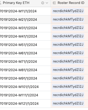

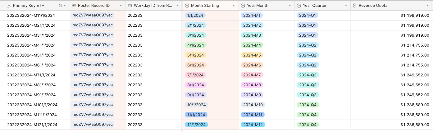

I appreciate the help. I'm still trying to conceive the design of this table (it's quite difficult). Let me breakdown some screenshots although I will likely still be vague due to being cautious of disclosing info. The main sheet I'd like is essentially populating the rows with the Revenue quota. You can see that the primary key is broken out by the emp ID and the month they would be assigned the quota

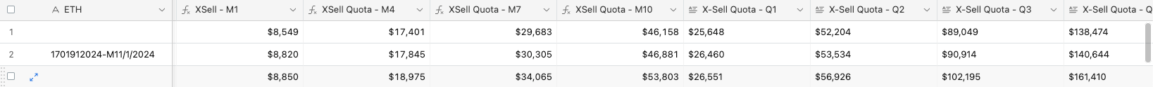

Im thinking to somehow link the primary key over but my main sheet where I would run calcs are essentially flipped / transposed.. Im wondering if I can do something with that. At the top, I would source over data likely at the quarterly level or sometimes monthly depending on the team that provides me the info. If not, its straightforward enough to break into monthly;
The challenge im having now is think about sourcing the data across the columns in this second screenshot over to the primary key that can get pulled nito one column "XSell Quota" vs. under the respective month (M1, M2, M4, etc).
The complexity is that in the table within the second screenshot, I have it broken down by territories (which I think I would somehow convert / assign in a table that is similar to the 1st primary key and this might just have to serve as a 3rd table in the process) that ultimately get assigned to a Person (lets call it P1) that reports into a leader (L1) and ultimately into a senior leader (SL1). Note that Several "Ps" could roll up into L1 etc. Sorry if its still ambigious but I am just trying to be cautious without disclosing confidential or personal data.

Hmm, apologies, I'm not really following.  If you could create a simplified base with some example data of what you're trying to do that would be really helpful; without knowing how your base is set up or what you'd like the outcome to be it's very difficult to help
I have no idea whether this is helpful, but I sometimes end up creating a summary table where each record represents a single person and time period, and then I create rollups based on that.  For example, I might have a table full of sales data where each record represents a sale and it contains the date of the sale and the sales agent.
I'll then create another table where each record represents a single sales agent and a single date period, so I'd end up with "Bob - Jan 2024", "Bob - Feb 2024", "Alice - Jan 2024" etc
I would then use automations to link the sales data to the appropriate summary record as needed, and use rollups in the summary table to sum up the total amount of sales made per agent per month
Sorry, I'm not even sure if what I've just mentioned is relevant, but I kind of think that's what you're trying to do?  Not sure!
