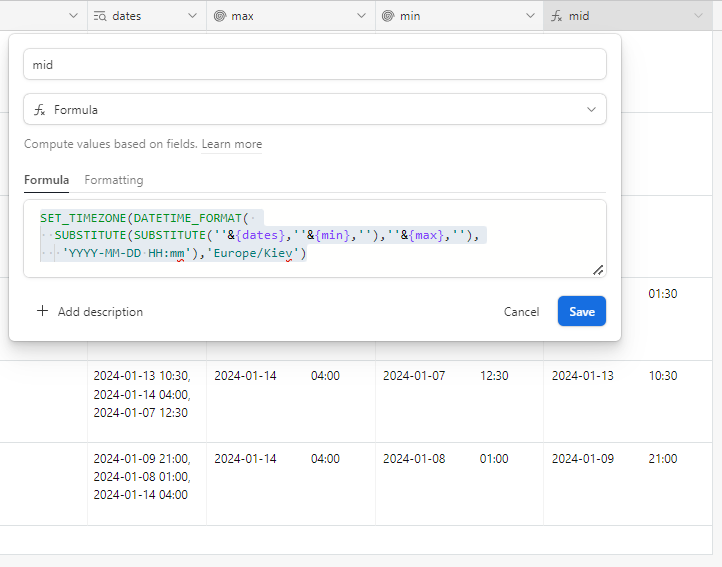

I have a feeling that 'series of back-and-forth rollups' solution is more 'correct', but it might be harder to implement.
On the other hand, you can substitute min and max from dates field and format the rest up to your needs
You should also format according to your time zone. See links to change the format and time zone.
Formula to copy-paste. Adjust field names and your time zone.
SET_TIMEZONE(DATETIME_FORMAT( SUBSTITUTE(SUBSTITUTE(''&{dates},''&{min},''),''&{max},''), 'YYYY-MM-DD HH:mm'),'Europe/Kiev')
