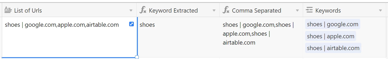

You could do this with a few formulas and an Automation.
Assuming your {List of URLs} field follows keyword + | + comma separated list of urls, then you can extract the keyword with this formula:
TRIM(
  MID({List of Urls}, 1, FIND(" |", {List of Urls}))
Then use another formula field to augment the original list to put the keyword in front of each URL:
SUBSTITUTE({List of Urls}, ",", "," & {Keyword Extracted} & " | ")

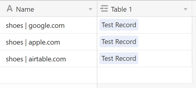

Then use an Automation to copy the {Comma Separated} field into your link to your Keywords table whenever the record gets updated.

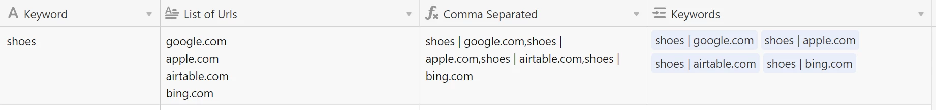

Your other table will look like this:

That’s even easier.
The revised formula for {Comma Separated} would be:
Keyword & " | " & SUBSTITUTE({List of Urls}, "\n", "," & Keyword & " | ")
Everything else is the same.

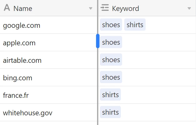

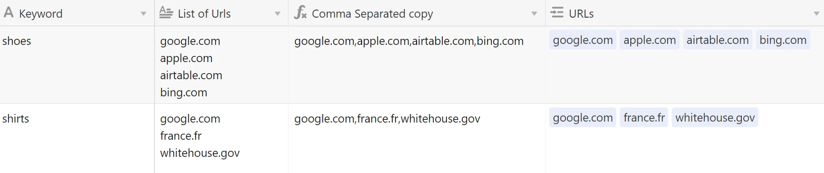

Its actually even easier than that if you want to avoid having two rows for “google.com” if its a keyword for both shoes and shirts:
If the {Comma Separated} formula is just:
SUBSTITUTE({List of Urls}, "\n", ",")
Then the second table would look like:
