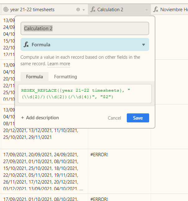

Thanks for writing out the formula for me. I have tried using it, but it’s not working:
What am I doing wrong?
Ooh! Actually, I read a little about Regex functions and changed the rollup field to a formula field with an arrayjoin function and it’s has given me the results I wanted. Thank you so much. :star_struck:
