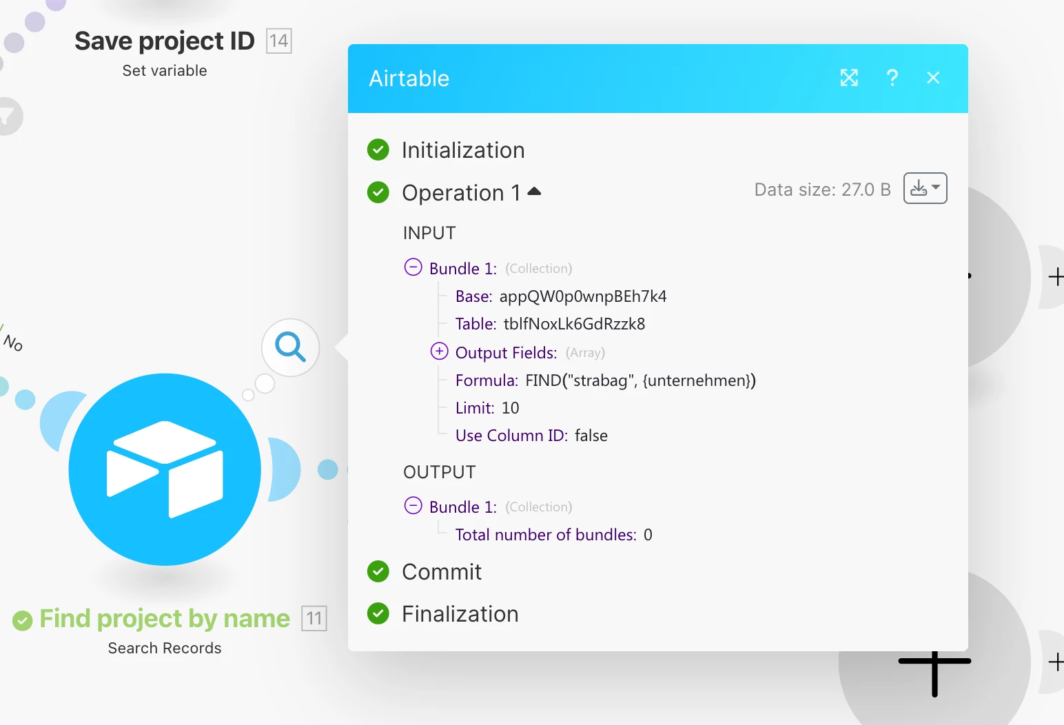

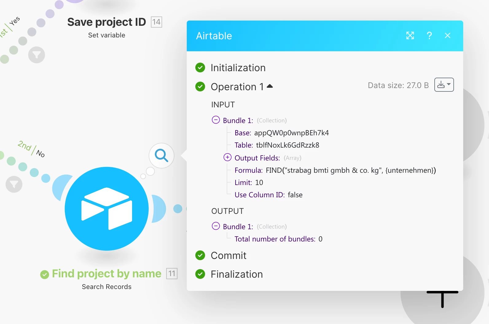

I tried using this formula:
FIND("{{lower(1.Company)}}", {{lower("{Unternehmen}")}})
It outputs the company but only if it matches exactly my input. So if I put "SEPHORA Inc." just like in the record, it finds the record. If I put SEPHORA, it doesn't.
Should it not also output the record now since my input string is part of the record company name?

vierless_julian
This one is not working but should:
This is when I do the exact name:
Those look like proper Airtable formulas. If you type your formula into an Airtable formula field, does Airtable yield the results you're looking for there?
