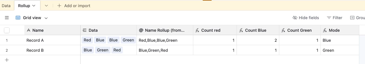

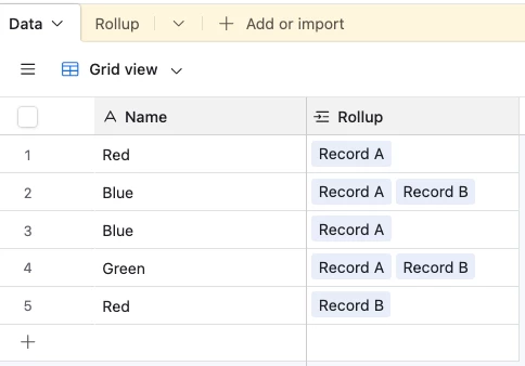

If your values are fixed then you could try a formula with LEN + SUBSTITUTE and a whole bunch of helper fields, and I’ve set it up here for you to check out.  Bit of a nightmare to maintain though

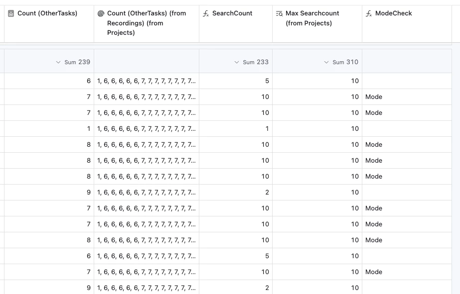

The count field in Table 2 is the number of tasks linked to Table 2 (Tasks is in table 3, not needed for this workflow. We start with just the count)

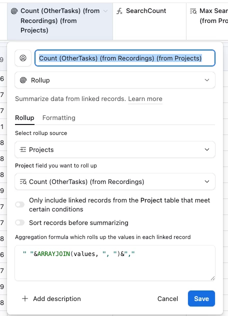

We lookup this count in Table 1, parent of table 2. Then create a rollup of the lookup back in table 2. I use a rollup to format the output with 1 leading space, and one trailing ‘,’ character. Why will become evident in the next formula.
Then the key field is the SearchCount field in Table 2. It counts how many times a number in a particular field has been found in the Rollup.
Now we have the frequency of each Count in the table 2.
We roll it up into table 1. This gives us the number of times the mode has surfaced

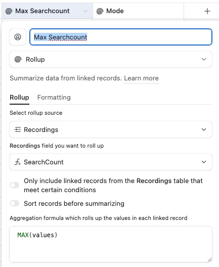

Then We look it back up in table 1, giving us the field indicating the number of times mode has surfaced ‘Max Searchcount (from Projects)’.

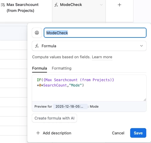

We lookup the MaxSearchCount in table 1 into Table 2, then we compare the SearchCount and Max Search Count, and label all the matches as Mode.

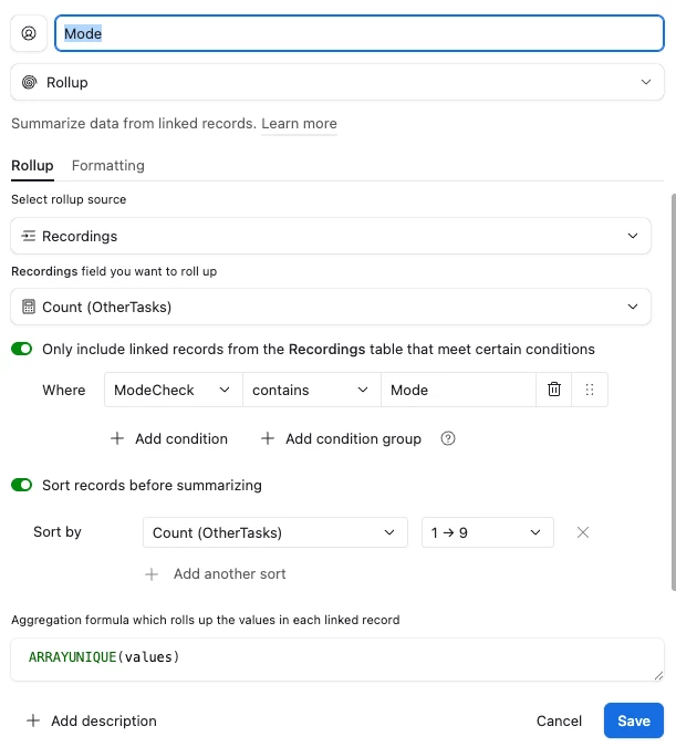

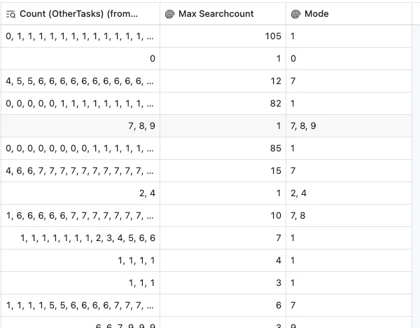

Now we rollup all Counts back in table 1, filtering for only the numbers where ModeCheck field outputs ‘Mode’
 There you have the mode. Note that Mode is not always a single number. It outputs all the modes of the distribution.
