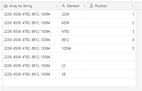

Best answer by kuovonne
Do you want something like this?
It isn’t clear if your array is a text string, a lookup, or a rollup.
If your array isn’t a text string, you will need to convert it to one first. The exact method depends on the field types involved.
Here is a formula where both the “array” and the string to find are text fields. If either is a different field type, this formula will not work.
On the other hand, I am not sure what your use case is, and I wonder if there is some better solution that does not involve getting the exact position.
  AND(
    {Element},
    FIND(" " & {Element} & ",", " " & {Array As String} & ",")
  LEN(
    LEFT(" " & {Array As String} & ",", FIND(" " & {Element} & ",", " " & {Array As String} & ","))
  LEN(
    SUBSTITUTE(
      LEFT(" " & {Array As String} & ",", FIND(" " & {Element} & ",", " " & {Array As String} & ",")),
  ) + 1

Thank so much - this worked brilliantly.

If you want to use Array Formulas, you can use the trick to change number to text in your Array Lookups
ARRAYJOIN(values,", ")&""
Then you can just remove all the extraneous quotations from above:
IF( AND( {Element}, FIND({Element},{Array As String}) ), LEN( LEFT({Array As String}, FIND({Element},{Array As String})) ) - LEN( SUBSTITUTE( LEFT({Array As String}, FIND({Element},{Array As String})), ",", "" ) ) + 1 )
