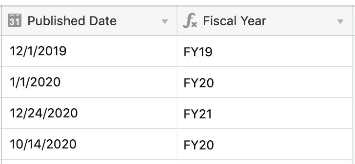

Ahh, yes, this is such a smart way to do it and I feel stupid, thank you.
One thing: the first row, 12/1/2019 should be FY20 because Dec 1 is the first day the next FY. But the rest of the rows are correct. So should I change the top date to “-11-30”?
Definitely not stupid. This is a tricky one with all the formatting and type conversions.
Yeah I believe so. It’s yours now. Feel free to mess around with it.
