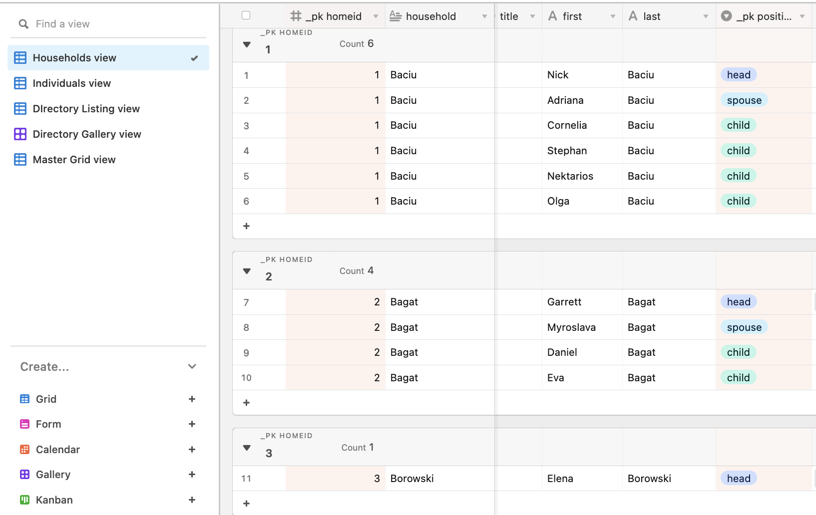

Airtable does a very nice job of organizing the individuals by household using the “Group by” function. Now we just need to pull the names in the group into a calculated fields, one for adults and another for children. Attached is screen shot of how the grouped records look.

You’re not going to be able to assemble your intended result until your records are linked together. Simplest way to do that would be to convert the {household} field into LinkToRecord field pointing at a (new) table for Households. The {pk homeid} field should live in the Household table since its unique per household, not unique per individual.
Your Households table will have a series of either Lookup or Rollup fields to pull in the {first}, {last}, and {ph position} fields. For your particular use case, that would mean one Lookup field pointed at the {last} field with the condition applied for “Position = head” and another Lookup also pointed at {last} with the condition “Position = spouse”. Now a formula field can determine if those two values are the same. You’d also want one Rollup with the ARRAY_JOIN(values, ", ") aggregation pointed at the {first} field with the condition applied for “Position = child”. That will give you a comma separated value of the children’s first names.

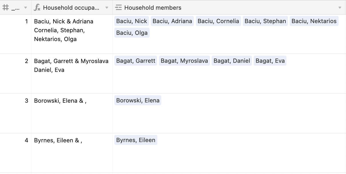

So far so good! Table “Households” created and linked via the _pk homeid (I think that’s what happened). LU fields created for Head Last and Head First, and Spouse Last and Spouse FIrst. When I tried creating a RU field for Children, however, I hit a snag: it told me “Sorry, there was a problem creating this field. The options are not valid.” But then just for the heck of it I tried creating another LU field for Child First, and it gave me exactly the results I wanted – a list of the children’s names separated by commas. Not quite sure why the RU didn’t work. Perhaps it had to do with how I created the related field: basically what I have is a field with a string of all the names in each household, separated by spaces.
When I applied your formula for the Household occupants, it basically worked but with two small problems: 1) for single Heads of households, there was a trailing " & ,", and 2) the children’s names (from my renamed {LU Children names} field) were NOT separated by commas, whereas in the table field they are.

@Kamille_Parks
Hi, I got the Rollup field to work. Now if would just help me get rid of the extraneous " & ," after the names of single heads of households, this issue will be solved! (see Nos. 3 and 4 below)
