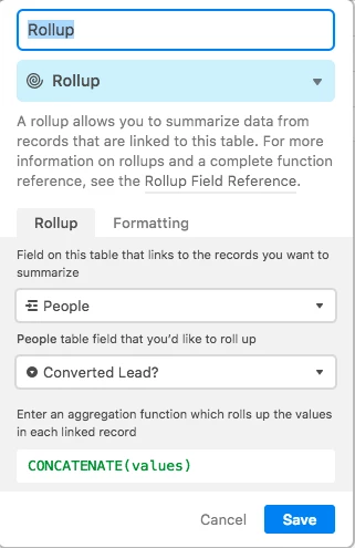

In the [Control] table, add a Rollup field:
That will give you something like this:
