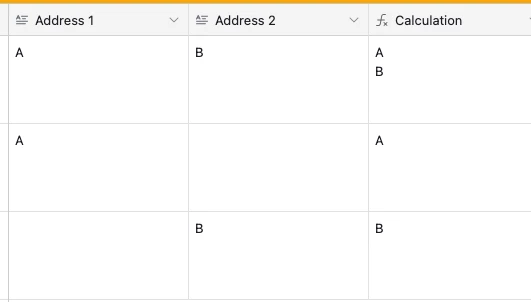

That looks good to me, is there an edge case that’s causing it to fail?
Extremely minor quibble, but we can skip the , “” at the end if it’s blank for the first three lines like for the last 3 lines
IF({Address 1}, {Address 1} & '\n') &
IF({Address 2}, {Address 2} & '\n')
Which still works fine:
