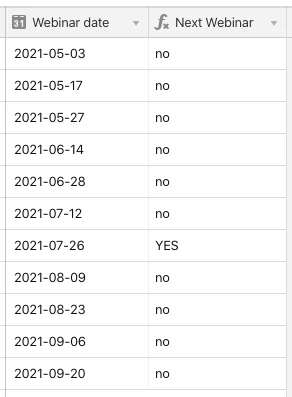

A more accurate method would be to use DATETIME_DIFF() to look at how many days there are until the next webinar date, and only mark those with “YES” where that difference is 14 days or less (I noticed that most of your dates are 14 days apart, though a couple varied from this pattern). Try this:
    AND(
        {Webinar date} > NOW(),
        DATETIME_DIFF({Webinar date}, NOW(), "days") <= 14
    "YES",
    "no"

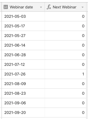

You could also simplify this a bit: drop the outer IF() function and the text output, which will put a 1 in the record of the next webinar, and a 0 in all the others. That would still allow you to filter for that next webinar (assuming that you’re using the output to drive a filter).
AND({Webinar date} > NOW(), DATETIME_DIFF({Webinar date}, NOW(), "days") <= 14)
If your schedule ever varies away from the 14-day pattern again, you could change 14 to a slightly higher number and it should still work.

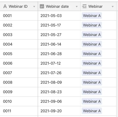

I made a [Webinars] table for this purpose and made a single record in that table. I then made a link field in the other table—which I’m calling [Webinar Sessions] for now—and set that to link to records in [Webinars]. I won’t get into the nitty gritty of link fields, but if you’re not familiar with them, I recommend checking out this overview:
In that field, I linked each webinar session record to the lone webinar record from the [Webinars] table. With that done, it looks like this:

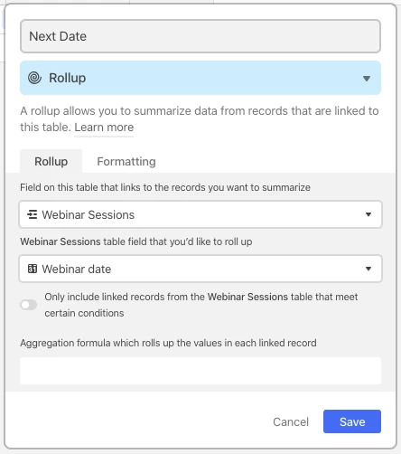

In this table I can add a rollup field. Rollup fields are designed to process data from linked records. This is done by targeting a single field from the table that’s the source of the linked records, and then telling Airtable what you want to do with the data collected from that field.
I’ll start setting up the rollup field like this, telling it to give me the contents of the {Webinar date} field:

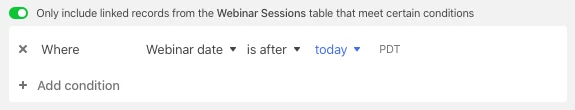

One of the options that you see there is to restrict the collected data to records that match a certain criteria. Switch that on, then set it as follows:
That isolates those records for webinars in the future.
